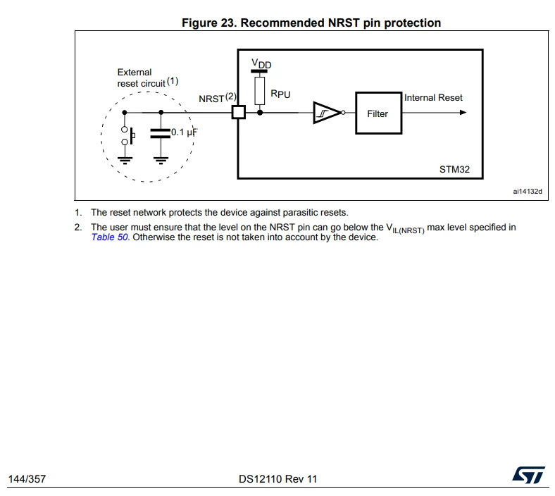

Andrew Neil
Apr 3, 2026 16:40 UTC
You don't have NRST on the debug connector, and a I don't see the recommended capacitor on it.
As @mƎALLEm said, see the hardware development app note, AN4938.
Also the datasheet:
You could also look at ST board schematics, for reference.

mƎALLEm
Apr 14, 2026 08:35 UTC
@QuirinS wrote:
Adding a pullup Resistor to NRST solved the problem.
Thanks for your help!
I don't think adding NRST is a solution. Perharps it hides another problem.
There is an internal pull-up resistor inside the chip on NRST pin. See the screenshot from the datasheet posted by @Andrew Neil
