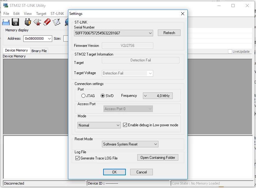

This is the dialog window when using the STLink Utility:

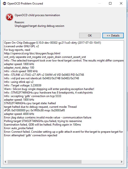

As you can see, we can't even detect the target MCU (STM32F746). Also, when we try to program it using SW4STM32, this is the output:

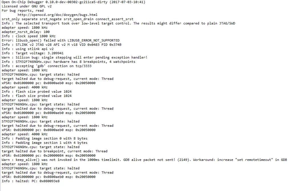

It seems like it's trying to use the JTAG connection to program, but we're using the exact same options as when we program the STM32F746G-Disco board. And that is always successful:
