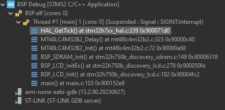

we are using STM32CubeIDE v1.14 & STM32Cube_FW_H7_V1.11.0 for STM32H750B-DK discovery kit.
whenever we try to flash any application (LTDC_Paint) or GPIO_Toggle or any example project, binary is getting flashed but CPU is getting stuck in HAL_GetTick() in MT48LC4M32B2_Delay() function always when we try to debug the firmware using on-board STLINK.
Please suggest way forward to resolve this issue.

July 7, 2024
I'm having exactly the same issue with the same board, but with a newer firmware version, STM32Cube_FW_H7_V1.11.2
This is the call stack:
The example is being build without any modification.

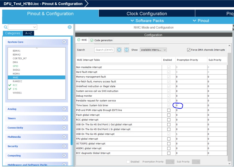

Can you try lower the SysTick priority to 0 and other to > 1?
That might work as it works for me!
Ayoub

The BSP project for the STM32H750B-DK kit doesn't come with a .ioc file.
I changed the SysTick interrupt priority to 0, but still hanging on the HAL_Delay.
It's just really weird, the most basic demo project of the kit simply does not work out of the box.

So you have SysTick interrupt priority set to 0 and all others > 1? can you please make a screenshot of your NVIC config?
Visitor II
July 11, 2024
As I said, the BSP project does not come with an .ioc file, so I can't configure it with MX.
What I did was:
still no luck...
If I start a new project using MX, the systick works fine, so I'm sure the board is not defective.
