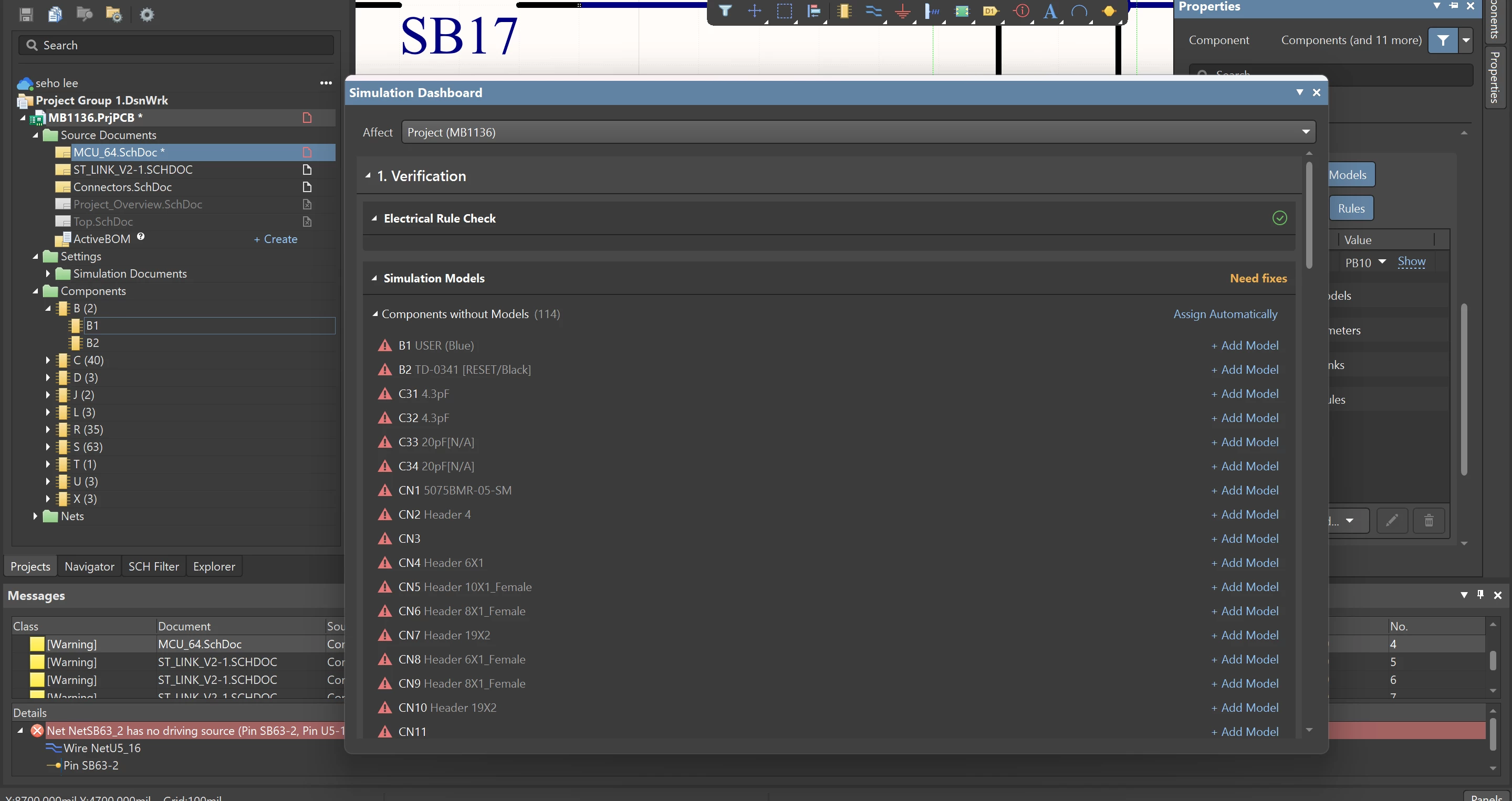

Could I get SCHLIB files or pspice model for Nucle-F103 (MB1136)?
Dear all,
I downloaded the schematic files for nucleo-64board(MB1136) from this page
(https://www.st.com/en/evaluation-tools/nucleo-f103rb.html#cad-resources)
and opened them in Altium.
However, when I tried to run a simulation, I encountered an error.
I believe I need an MB1136 SCHLIB file or SPICE library files
to properly simulate this board.
Could you please provide the SCHLIB file or a PSpice model for MB1136?
I apologize for any inconvenience, as I am new to Altium.
Thank you

Hello Seho,
There are no models attached to the components in the Altium library in the shared schematics on ST.com
I'm not sure that this can address your point but :
To generate a schlib : on Altium Designer Menu:  Design -> Make Integrated Librairy ( or schematic Librairy) from the project open.
Best Regards .
Sco
April 27, 2025
If you consider it's an issue linked to the Lib, you can refer to MB1932:MB1932 - Resources - Search STMicrocontrollers. MB1932 is a board very similar to MB1136.
