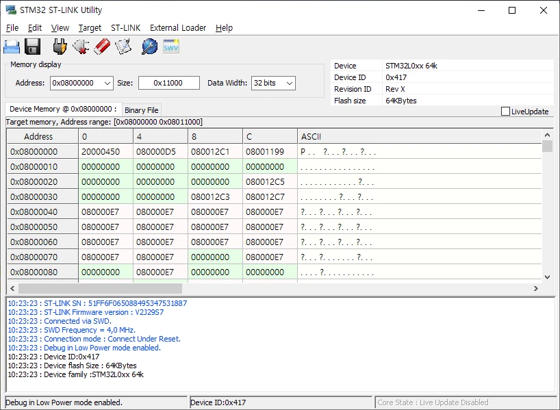

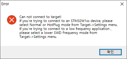

Connection failed when trying to connect STM32L053R6T6 using STM32 ST-LINK Utility Version 4.50 as a latest version.
When we connect STM32L053R6T6 using STM32 ST-LINK Utility Version 4.20, it works normally.
But when trying to connect it using STM32 ST-LINK Utility Version 4.50 as a latest version, it fails.
Please refer to the attached files.
Please let us know how to solve this issue asap.
Thanks.

Try backing off the connection speed on CM0 devices​
