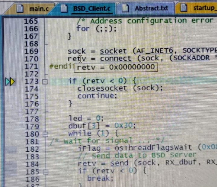

Hello, how are you! I am working with a project in the KEIL STM32756G_EVAL environment. Initially, the microprocessor was connected to an external 8 MHz clock generator, so the CAN bus operation was distorted. I purchased a 25 MHz quartz resonator and installed it on the Nucleo-F756ZG board. Removed the SB149 jumper and added two capacitors C37 and C38 (5.6 pF), and installed two SB8-SB9 jumpers that connect the quartz resonator to the microprocessor. After power was applied, the microprocessor started and began to correctly generate CAN bus signals. However, the Ethernet interface stopped working. Even the "ping 192.168.0.100" command does not work. So, I need help to fix the Ethernet problem.

I apologise to the honest company, but I found that two more jumpers on the PCB can somehow affect the operation of the X3 25 MHz quartz resonator (maybe they cause a shift in its frequency?): SB112 and SB163.
I will remove them and report the result later.
vvdolinAuthor
October 1, 2024
I removed the jumpers - nothing changed in the program operation.

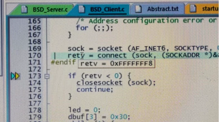

I checked the presence of 50 MHz in the "RMII_REF_CLK" circuit - such a signal is present.
The processor seems to work as it should, but network services do not work. For example, the BSD client does not connect.
It is not possible to examine the program code in more detail, since it is hidden in the library.
Apparently, I need to roll back to the frequency of 8 MHz.
vvdolinAuthorBest answer
October 3, 2024
I've rolled back to the frequency of 8 MHz.
Network services are working again.
I suggest considering this topic closed.
