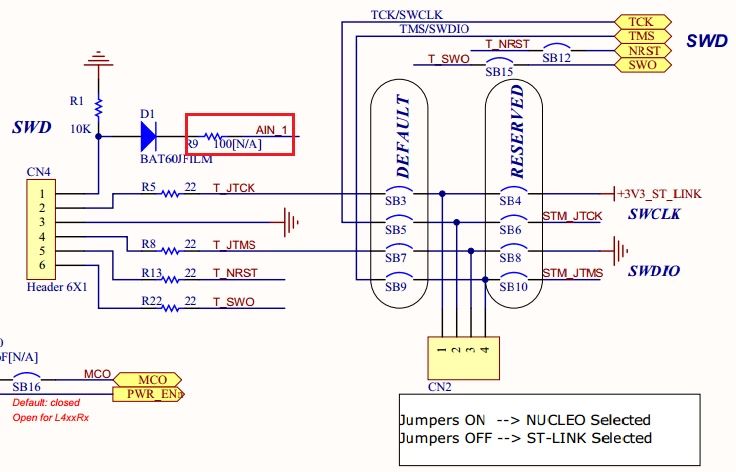

hi,  fellows!
I have some questions about ST-Link, especially those on Nucleo boards.
First, I often use the on board st-link link to debug/program some other custom boards, it works fine.
But someday, I'd noticed that the debugger's AIN_1(target VCC) is never  really connected to the MCU VCC
of the application board, for R9 is not lying there. See below:
From the UM1075 User manual of ST-Link, it says:
The power supply from the application board is connected to the ST-LINK/V2 debugging and programming board to ensure signal compatibility between both boards.
So is this really unnecessary? (For me, the debugger/programmer works fine so far.)
Or is this risky for some reason?

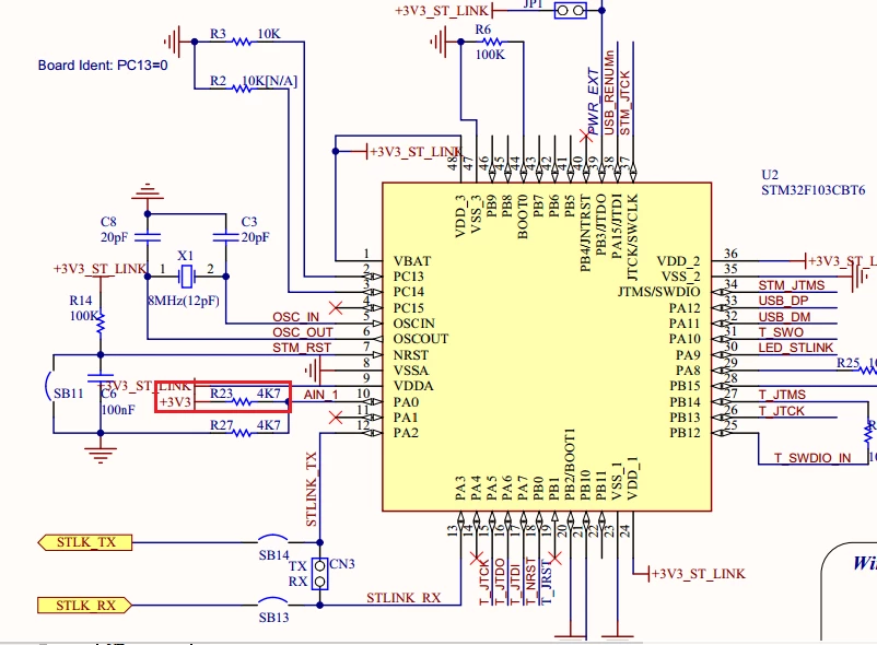

For we are making a project with the whole nucleo board as a part,
 with st-link on it.
And I've already removed R23 for saving power.
See below:

Posted on June 08, 2017 at 20:00
The stand-alone ST-LINK has buffers so that the debugger and the target board can run at different voltages. The NUCLEO/DISCO boards don't have these buffers, and just use/assume the use of 3.0V or 3.3V signalling.
Most of the pins are 5V tolerant, and the VIL/VIH vs VOL/VOH provide a lot of leeway.
The idea would be to avoid back-feeding current into a processor via the GPIO pins and skewing the current measurements.
If the target STM32 were running at 1.25V I'd probably want the buffers

Posted on June 09, 2017 at 01:14
Thanks Clive, as always!
So since my target MCU is running at 3.0/3.3V, there is a lot of leeway.
Guess I can sleep well with the target VCC pin left open!
