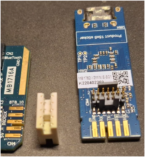

Pavel A.
Jan 17, 2026 11:56 AM UTC
For the CN2 (on the edge) use this connector, specially for low-cost edge connection. No pins, no holes, no cable.

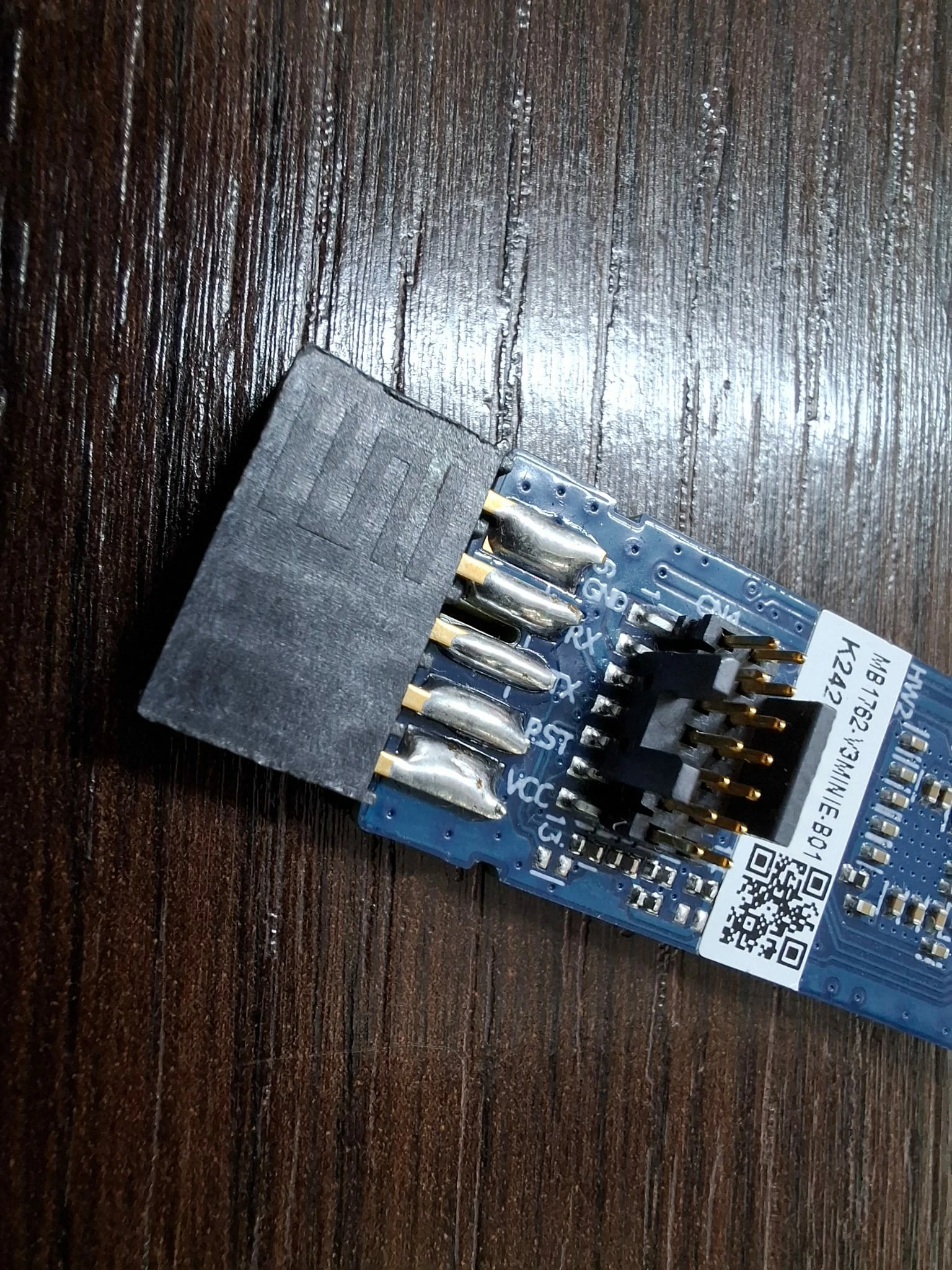

Hi @S.Ma , thanks for the hint as far I see the DF11 series is just a 2.0mm "Pitch, Double-Row Connector" with no card edge options, If I've understood correctly your message you're suggesting to solder a 2mm pitch connector to the STLINK-V3MINIE programmer in order to make it compatible with DF11 mating parts. Please correct me if I am wrong.
I already do this in my lab even with 2.54mm pitch headers (which fit with an acceptable tolerance), pic shown below, but as I said in my original post I don't want to customize the STLINK-V3MINIE boards since this solution will be installed on the other side of the globe respect to us and we want the end customer make maintenance locally without sending them spare parts (modified stlinks) but ordering themselves online (original stlinks).
This is why I was asking for a compatible "wire-to-card edge" connector. I hope I made myself clear, sorry non native speaker here.

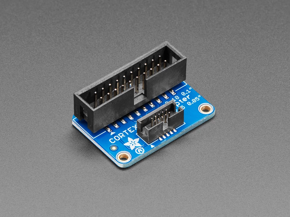

Long story short, given the lack of commercial solutions with the B2B CN2, we went with a COTS solution of this type (the STDC14 cable is already included with the programmer):
https://www.adafruit.com/product/2094
To which I would pair a Hirose HIF3B connector (a female "idc style" connector that accepts wires).
HIF3BA-20D-2.54C(63) + crimp AWG22-26 HIF3-2226SC
Luca
