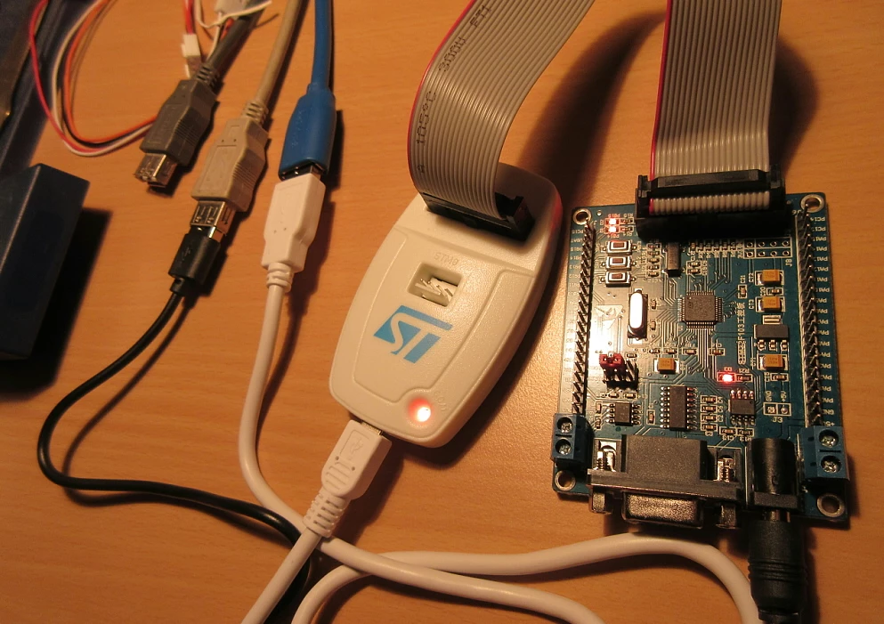

> I bought STLINKV2
the real thing or a clone?
> small board with STM32F103C8T6
They are often ***.and/or fake.
You will be better off with a geniue Nucleo board or the STM32C0116-DK - Discovery kit with STM32C011F6 MCU - STMicroelectronics
hth
KnarfB
Andrew Neil
@KnarfB wrote:
> I bought STLINKV2
@JerryMC22 - see: https://community.st.com/t5/stm32-mcus/how-to-recognize-a-genuine-st-link-v2-versus-a-cloned-one/tac-p/703663/highlight/true#M965
@KnarfB wrote:
You will be better off with a genuine Nucleo board
Absolutely!
JerryMC22Author
I know, I have this:
