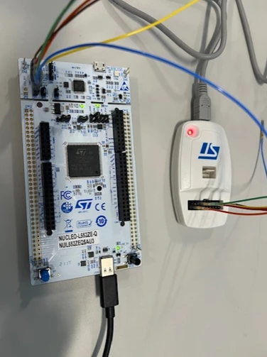

CN5 SWD connection with external ST-Link v2 does not work on STM32L552ZET6Q Nucleo-144
Embedded ST-Link via CN1 USB is working fine. I followed the direction as below when external ST-Link v2 was tried on STM32L552ZET6Q Nucleo-144. The error message "No Target" was displayed on STM32CubeIDE with external ST-Link. Could you provide me with any advice?

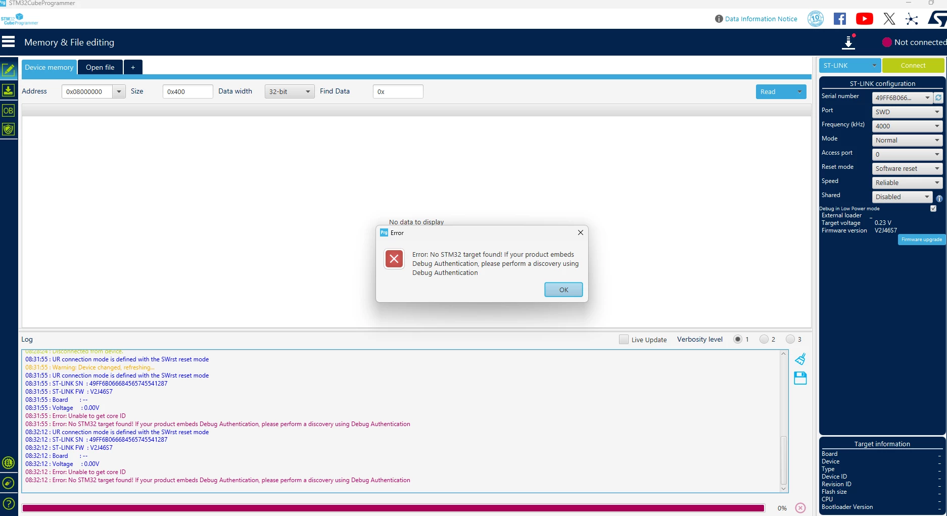

A few questions:
  • Why use an external programmer instead of the on-board one?
  • Is the board powered? How?
  • Is your programmer a genuine ST device? I don't particularly care but knock-offs tend not to work well with STM32CubeIDE.
  • Try connecting with STM32CubeProgrammer. Does it report a target voltage? Does it connect? Show screenshots if you get errors.

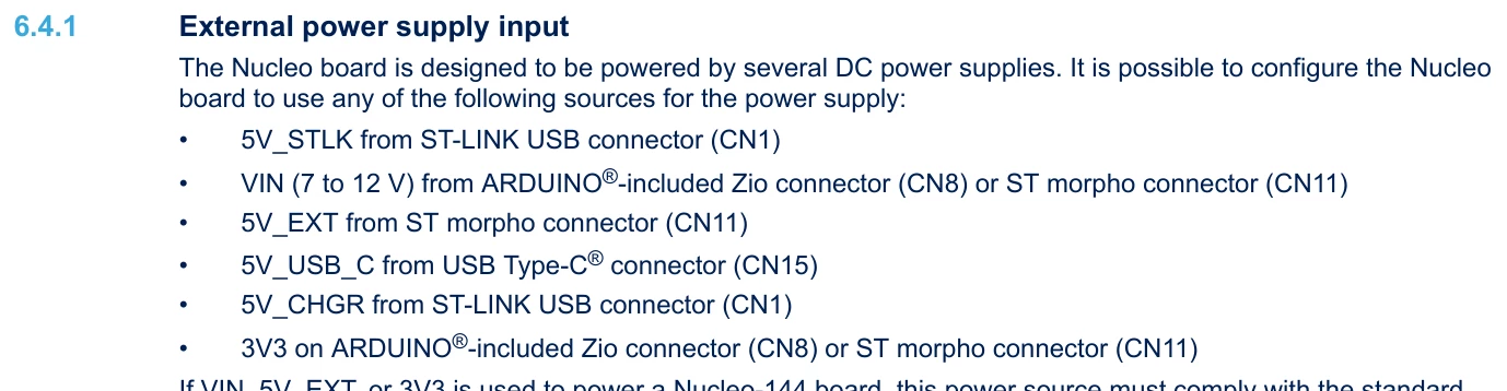

2. USB C at CN15 is used as board power supply. pin 7 and 8 is on JP6 for external power.

4. Please check the screen capture as below. Target board voltage is pretty low as 0.23 (Probably shall be around 3.3v).
USB C is not enough external power?
Feb 19, 2026 5:11 PM UTC
0.23 V is not enough voltage for the device to run.
How is the device powered? The programmer does not provide power. The VCC pin is an input to the programmer.

pin #1 on CN5 is connected to pin #1 on 20 pin connector of ST Link v2. L552E-Q board is powered from USB C (CN13). Board connection with ST link v2 is captured as below.

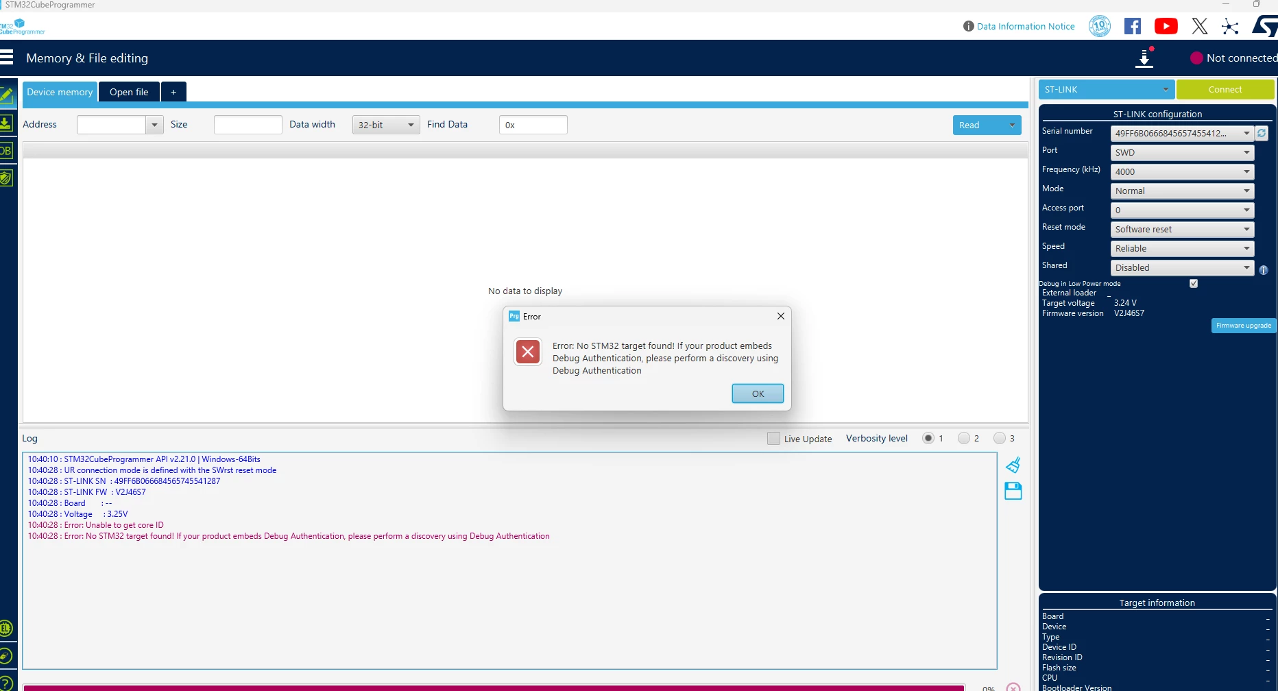

mattcyleeAuthor
Feb 19, 2026 6:43 PM UTC
After CN5 pin1 is connected to 3.3V on CN8, target voltage is 3.24v. However, still NO STM32 target found.
Feb 19, 2026 5:12 PM UTC
There are a number of ways to power the board. You need to have one of those present. See the user manual for details. CN15 should work.
TDKBest answer
Feb 19, 2026 7:05 PM UTC
CN5 is no longer connected to SWD on the target chip since you've disconnected CN4. It's connected to the st-link chip.
https://www.st.com/resource/en/schematic_pack/mb1361-l552zeq-c02_schematic.pdf
If SWDIO/SWCLK (PA13/PA14) is exposed elsewhere that would be best. It's on some headers. If you connect CN4 it may not like another programmer trying to drive those lines.
mattcyleeAuthor
Feb 19, 2026 7:31 PM UTC
After two jumpers are back to CN4, external ST-link v2 starts working. Thanks for your support.
