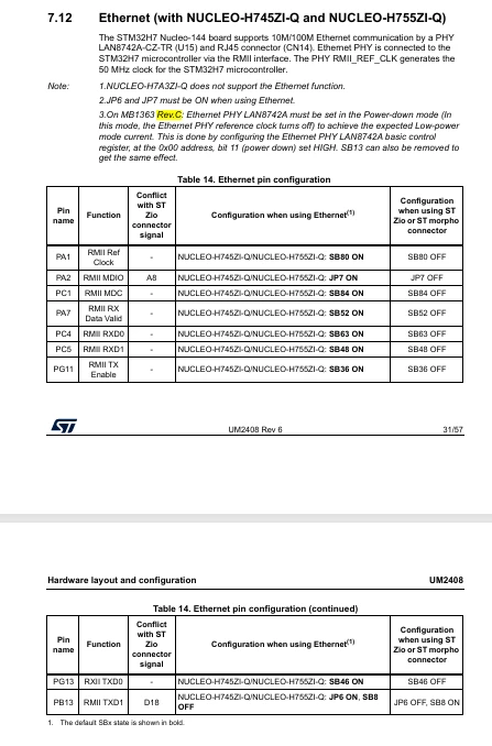

In Section 7.12 - Ethernet, Note 3 states:
"On MB1363 Rev.C: Ethernet PHY LAN8742A must be set in the Power-down mode [...] SB13 can also be removed to get the same effect."

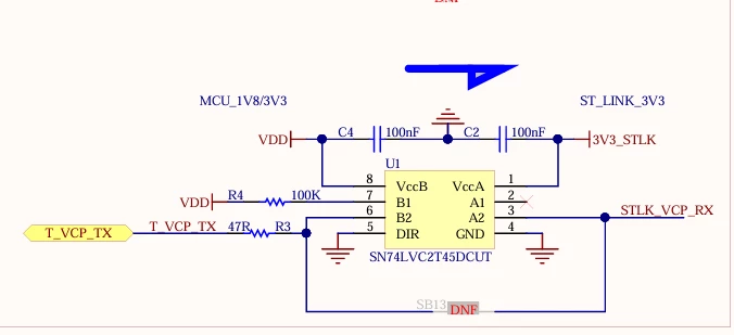

However, when checking the schematic (mb1363-h755ziq-d01_schematic.pdf), SB13 is actually located in the ST-LINK Virtual COM Port level translator circuit (U1: SN74LVC2T45DCUT) between STLK_VCP_RX and T_VCP_TX, and is already marked as DNF (Do Not Fit).
It seems SB13 in Note 3 is a documentation typo pointing to the wrong solder bridge.

Schematic diagram of the ST-LINK Virtual COM Port level translator circuit (U1: SN74LVC2T45DCUT) highlighting the position of solder bridge SB13 (marked DNF).

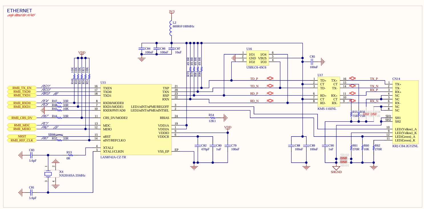

Schematic diagram of the Ethernet section (LAN8742A PHY) on the NUCLEO-H755ZI-Q board.

Following this logic, if we simply remove the signal solder bridges (SB80, SB48, SB63, etc.) according to Table 14 to isolate the MCU, the LAN8742A remains fully powered on its main VDD lines with all its digital control and data inputs left completely uncommitted and floating. In CMOS architecture, doesn't leaving input pins floating while the power rail is active risk causing severe internal cross-conduction, unpredictable leakage currents, or eventual thermal degradation inside the PHY? Furthermore, with the PHY still running, won't its internal 50 MHz oscillator continue to drive an un-terminated RMII_REF_CLK signal into an open trace, potentially creating significant high-frequency noise and electromagnetic interference across the board?
To mitigate these risks and safely neutralize the chip, this leaves us with exactly two potential correction paths—either via software control or a permanent physical modification. The software route would require keeping the MDIO/MDC lines temporarily connected to execute an initial startup code that sets bit 11 of the Basic Control Register to force a low-power state before reconfiguring the MCU pins. Alternatively, the physical approach would involve forcing a permanent hardware reset by opening SB98 and tying the PHY’s nRST pin (Pin 15) directly to Ground (GND). Theoretically, tying nRST to GND should keep the internal logic frozen, shut down the 50 MHz clock output, and force all remaining floating IO pins into a safe, high-impedance state without needing to physically desolder the entire QFN package.

As an update, I looked into the Microchip LAN8742A-CZ-TR datasheet and schematic. It appears that keeping the nRST pin (Pin 15) tied permanently to Ground (GND) is a viable solution, as a hardware reset forces all digital RMII outputs into a true high-impedance (tri-state) mode while shutting down the internal clock. Furthermore, since most of the critical RMII lines on the MB1363 board already include 10kΩ pull-up restoration resistors, my previous concerns about uncommitted floating lines causing internal CMOS cross-conduction might be incorrect.
Could you please confirm if holding nRST permanently LOW (by opening SB98 and tying the PHY side to GND) is fully supported and safe for long-term operation? Will the presence of the onboard 10kΩ pull-up resistors cause any unexpected current leakage or conflict with the MCU/FPGA lines when the PHY is held in this permanent hardware reset state?

I think SB13 in UM2408 is a documentation typo, maybe a copy-paste mistake. You can find similar description in the other user manual and schematic. Its original purpose is to meter current consumption of STM32. It says so “To get a correct current consumption, the Ethernet PHY must be set in power-down mode or SB13 must be removed. Refer to Section 7.11: Ethernet for details”. SB13 is a solder bridge between PA1 of STM32 and RMII Reference Clock of LAN8742A. Removing SB13 is for metering current consumption of STM32 system, not for powering down PHY.
Back to questions.
Q1. Putting LAN8742A into power-down mode has two ways, setting bit 11 in the Basic Control Register or strap MODE[2:0]  pins to power-down mode during reset.
Q2. Force LAN8742A stayed on reset state, or remove jumpers/solder bridges between those pins you desire to use.
Q3. …depend on ST...

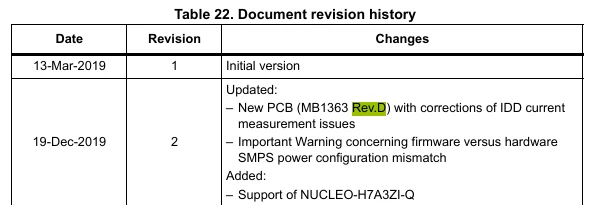

1. The note explicitly mentions MB1363 Rev.C, but the NUCLEO-H755ZI-Q actually uses the MB1363 Rev.D-01 board revision
According to the Document Revision History (Table 22), Rev.D specifically introduced layout modifications to correct the IDD current measurement issues. This perfectly matches the historical context provided earlier regarding old current metering workarounds.
2. Furthermore, the Ethernet schematic sheet for this family contains the hardware note: "ETHERNET only fitted for H745".
This suggests that the Ethernet block (marked “ETHERNET only fitted for H745” on the schematic) and the related documentation notes may have been originally written for the NUCLEO-H745ZI-Q and then shared with the H755ZI-Q user manual, possibly without updating the solder bridge references (such as SB13).
Could ST please clarify how the Ethernet PHY isolation procedure changes now that we are on Rev.D-01 instead of Rev.C, and confirm if forcing nRST low remains the only valid option for the H755 variant?

Looking at the Ethernet Sheet, the main power of the LAN8742A PHY is connected to 3V3_PER through the L2 ferrite bead, but the pull-up resistors on the configuration lines are connected to VDD_MCU. The 3V3 PWR section previously shown shows that 3V3_PER is generated from the main 3V3 rail through SB1, and shows that SB13 does not control the power received by the PHY.
LAN8742A PHY powered by 3V3_PER through L2, while configuration lines are pulled up to VDD_MCU.
