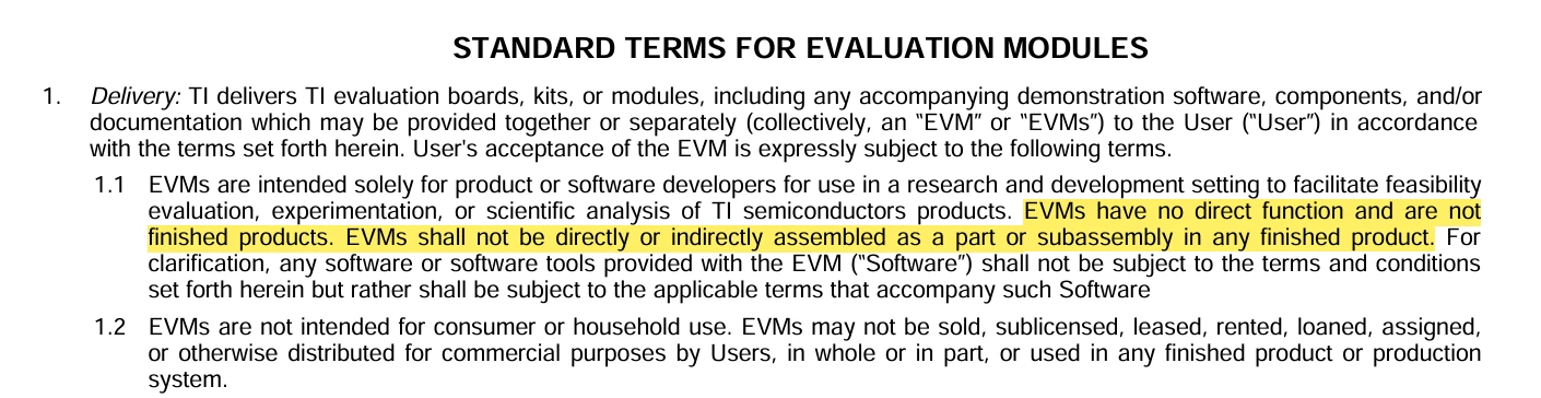

Just wanted to say that this is standard across manufacturers, not ST specific. Here is TI's clause. It even has the same weird "not finished product" wording.

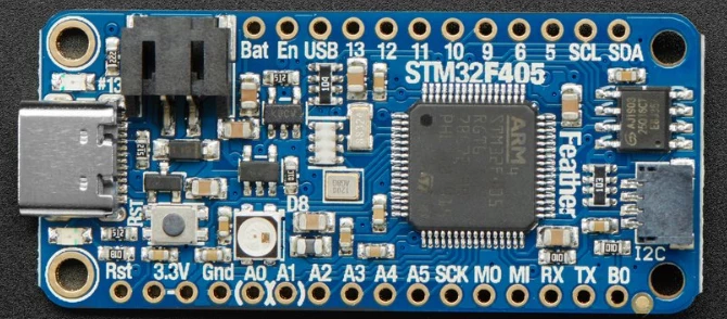

Adafruit sells a few small STM32 boards, here's one:
adafruit/Adafruit-Feather-STM32F405-Express-PCB: PCB files for the Adafruit Adafruit Feather STM32F405 Express
