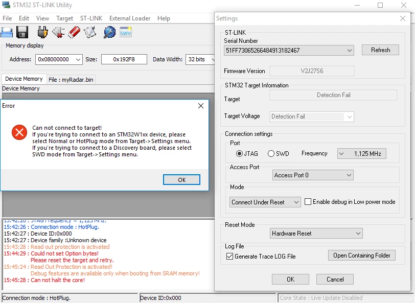

I have been working with an STM32F437 chip for a while now, when suddenly I could not flash my program in my IDE anymore. I tried solving the issue in ST Link Utility.

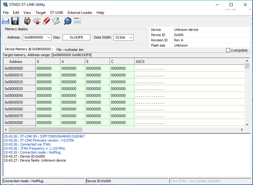

First of all, the only mode in which I can connect to the chip is HotPlug mode. I can't get any connection to the chip with normal or with connect under reset mode. I also tried pulling the reset-pin of the chip low/ releasing it when connecting. Also, in hotplug mode, my chip does not get recognized correctly.

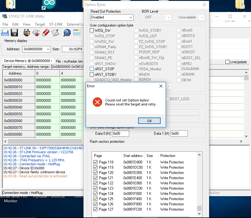

I tried erasing the chips content, (again also tried it when toggling the reset pin), but I always get the message ''readout protection enabled''. So I went to the option bytes menu and tried disabling it. However, this error occurs:

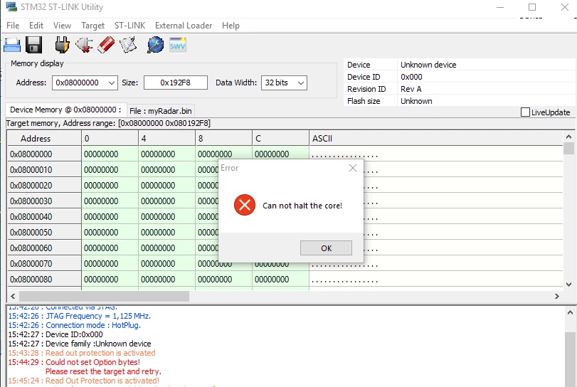

When I enter that menu while I actively pull down the reset pin, the page looks a bit different (e.g. distinct levels of readout protection). But I still am not able to disable the readout protection. In other menus, I often get the following error:
What else is there I could do? Is there any possibility of restoring the chips functionality? Or has it simply broken. The issue arised very suddenly when debugging some code, it worked fine before. It also does not seem to run the last program I flashed onto it (some LEDs should blink, but they don't).

Use SWD mode, not JTAG
Pull BOOT0 High so that it enters the System Loader, and not your code.

SWD is a subset of JTAG connectivity, you wouldn't have to build anything.
Chips that have been locked down are unrecoverable, part of the protection is to remove debug connectivity.
Physically damaged devices are also not recoverable. Check with a secondary board.
