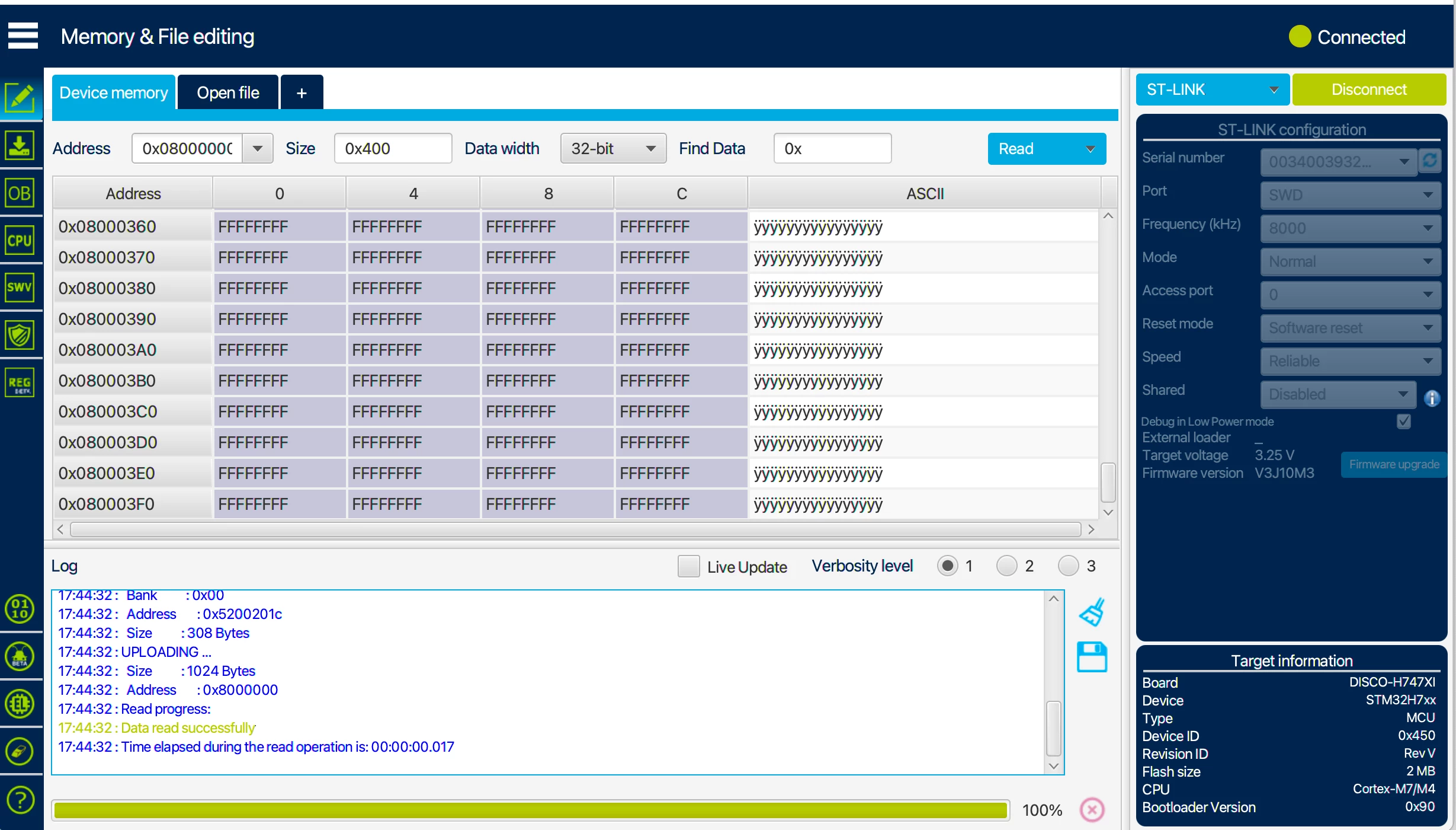

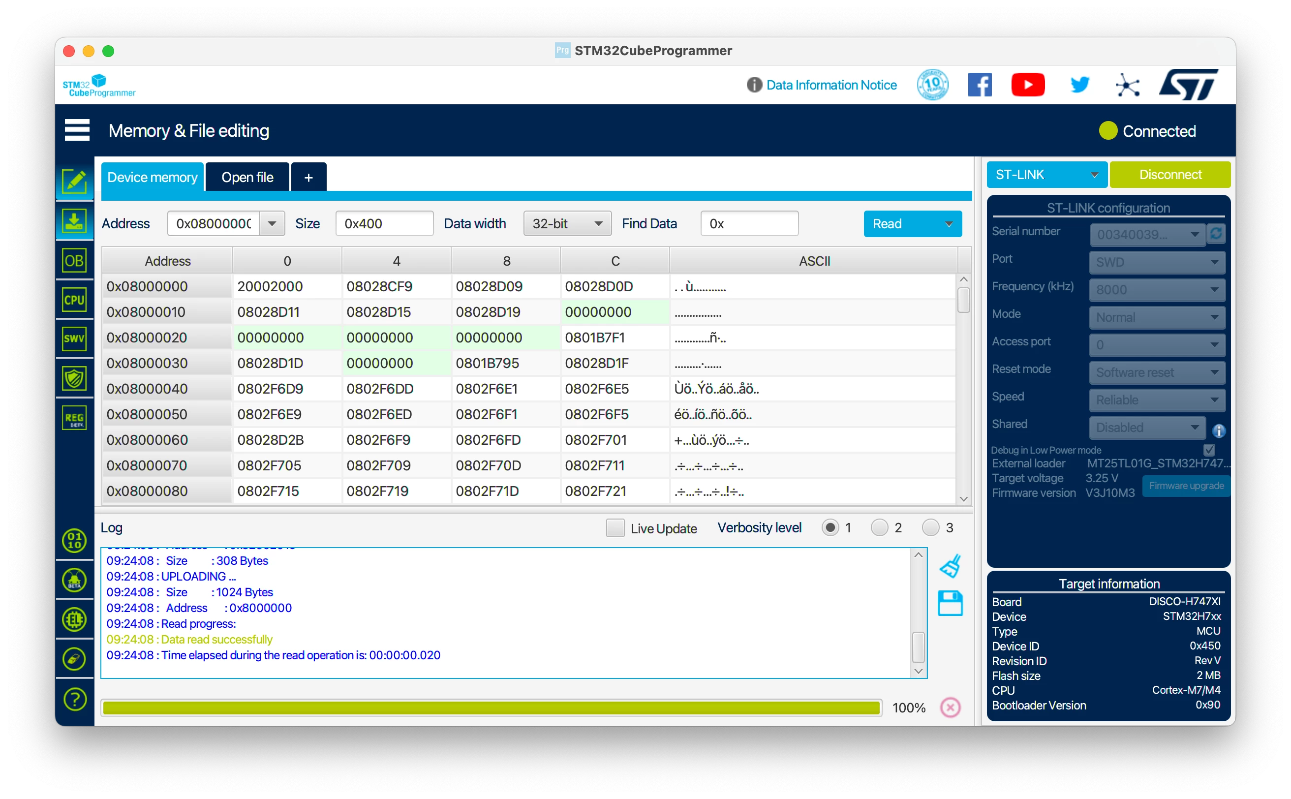

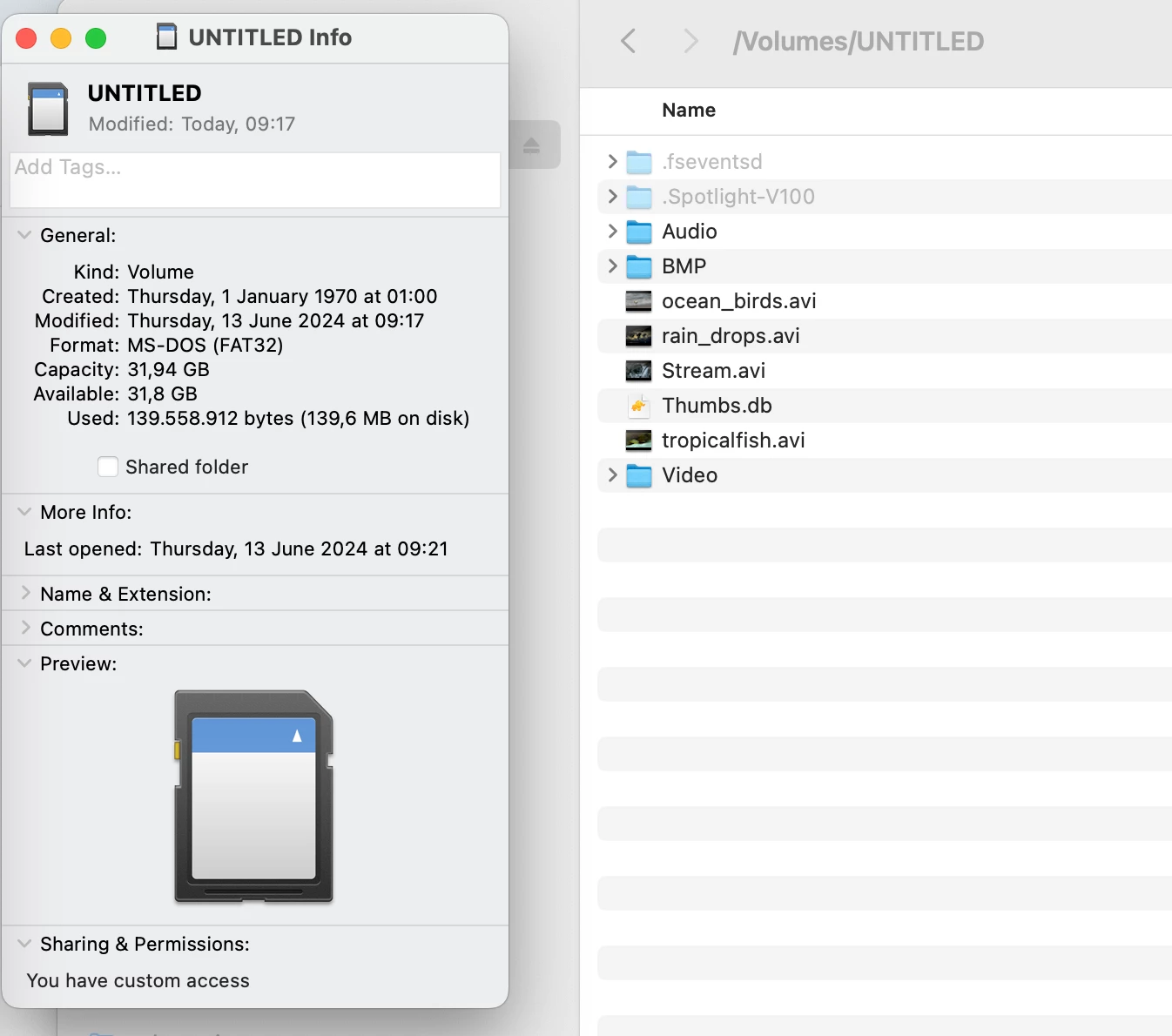

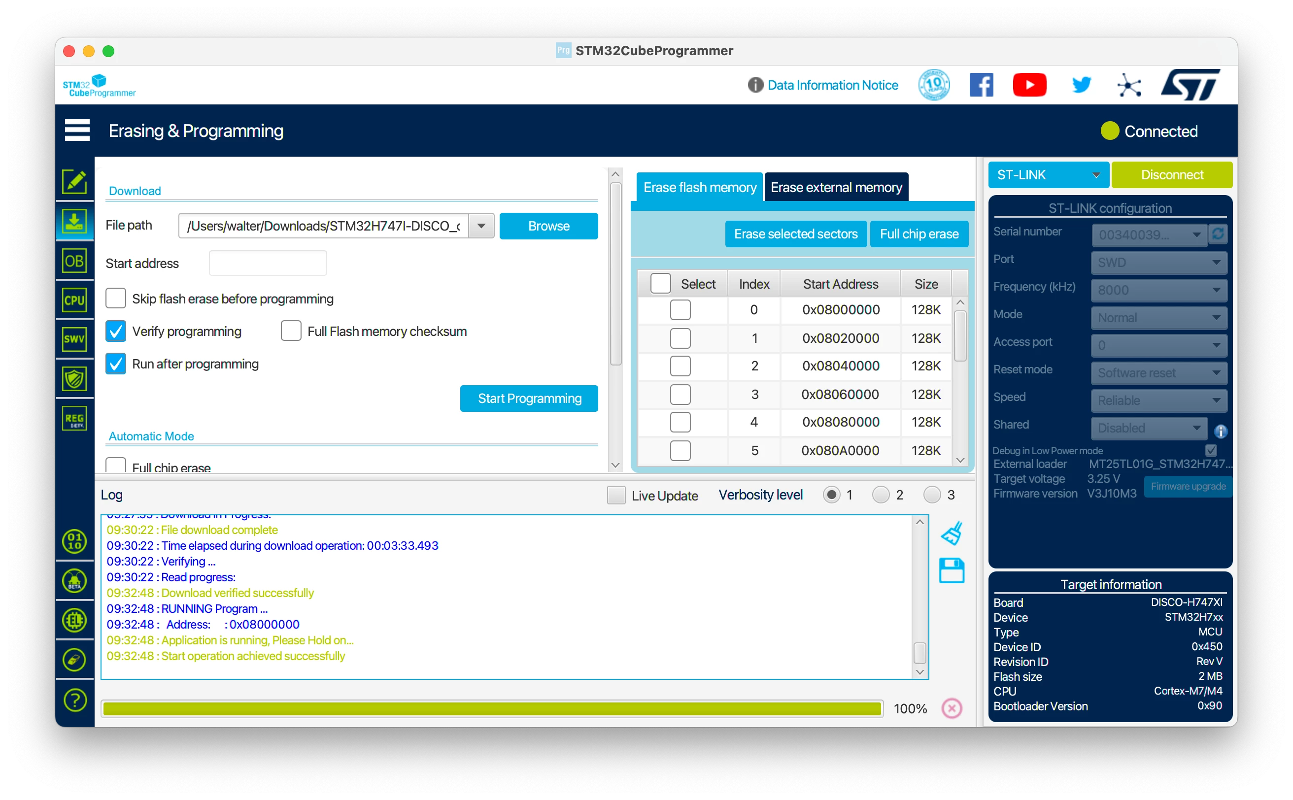

I've tried everything from scratch:
  • formatted the SD as MS-FAT (FAT32)
  • copied multimedia files (see image)
  • followed the readme in the latest download :
  • 2- Open STM32CubeProgrammer, go to "External loaders" menu then check "MT25TL01G_STM32H747I-DISCO" box
    3- Connect the STM32H747I-DISCO board to PC with USB cable through CN2 and click on STM32CubeProgrammer "Connect" button
    4- Use "STM32Cube_Demo-STM32H747I-DISCO-VX.Y.Z_FULL.hex" file provided under "Binary" with STM32CubeProgrammer
    to program both internal Flash and external QSPI memory.
    - From Erasing and programming Menu browse to select the "STM32Cube_Demo-STM32H747I-DISCO-VX.Y.Z_FULL.hex" file (mine is STM32Cube_Demo-STM32H747I-DISCO-V1.0.0_FULL.hex dated from 27 Feb 2019)
    then click on start programming
  • I've also set "verification on" and "run after programming"
Everything is OK but nothing shows on the display. The main led blinks
Any idea on what I am missing?
There is something basic I think.. why the led blinks?
Thanks
W

Jun 14, 2024 3:25 PM UTC
Hi again @walterg
Unfortunately Demo binary is built for an old revision of the board and it is no longer maintained. Could you try the updates to support Dynamic ID? You need to update patch of CubeH7.
Update STM32H747I-DISC BSP board drivers to support Dynamic ID · STMicroelectronics/STM32CubeH7@dd1b1d7 (github.com)
To give better visibility on the answered topics, please click on "Best answer" on the reply which solved your issue or answered your question.Best regards,FBL
