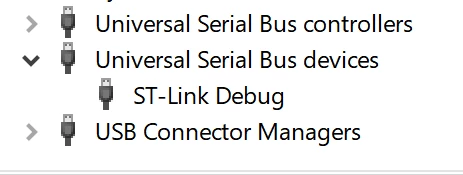

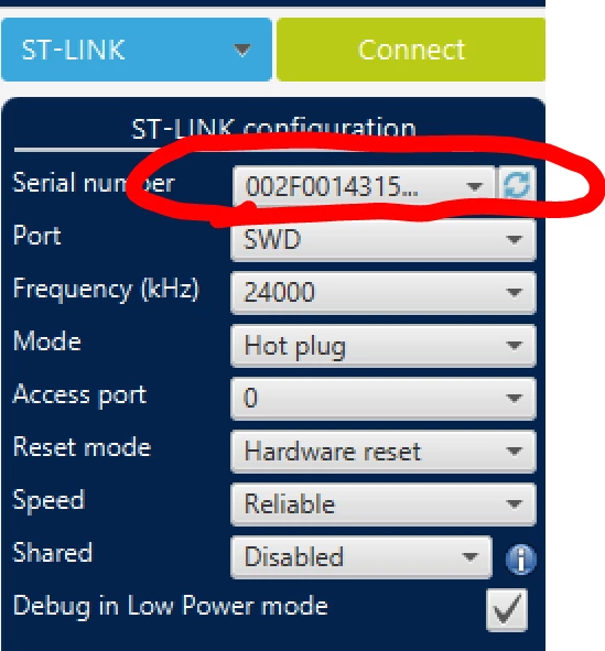

Download and install STM32CubeProgrammer, reboot machine, then load STM32CubeProgrammer. Is the ST-Link detected and does it have the serial number displayed?
If not, go into device manager. Anything there with a yellow exclamation mark? If so, show it. It should look like this:

no serial detected, and still the BULK interface with a exclamation mark in the device manager.
With all the trials I have made at some point I managed to have this BULK interface without an exclamation mark, and under "Universal Serial Bus Controllers" but I think that is still wrong anyway, I never had it "ST-Link Debug" like you have.

Its serial number is in STM32CubeProgrammer.
