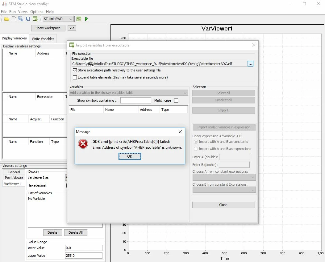

When I try to import a variable to view I get an error message (picture attached) stating:
GDB cmd [print /x &(AHBPrescTable[0])] failed:
Error: Address of symbol "AHBPrescTable" is unknown.

Some constructs of variables are not supported by STMStudio, just click ok and continue.
I get 10 or so of those errors when I'm importing the elf of my projects.
I believe this is due to some things being optimized by the compiler, where they do exist in the symbol table, without actually being linked. I never bothered to look into this further.

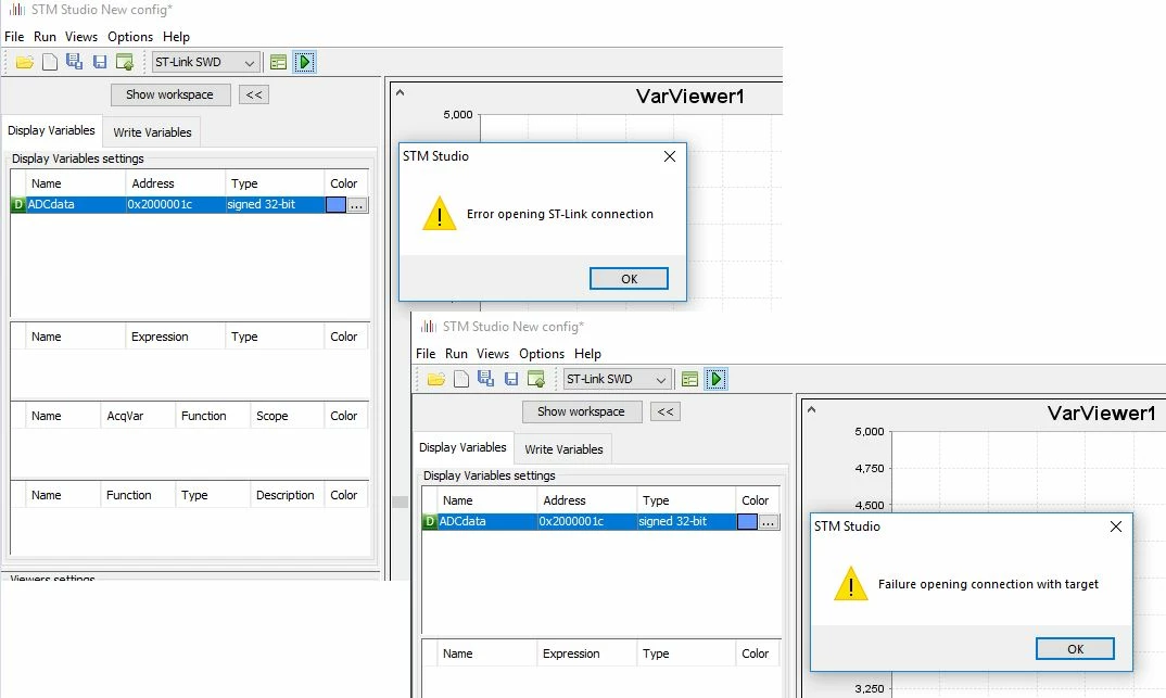

Thank you for your kind reply. I must apologize for my delayed response. I have managed to push past the initial errors (about 3 of them) as you suggested. I got my variable populated under "Display Variables settings", but when I press the "play" button, I get a few more errors. These say: Error opening ST-Link connection and Failure opening connection with target (picture attached). I feel like this has something to do with the SWD, but I cannot say for sure. Have you encoutered these errors before? Thank you

You could check the map file to see where it's supposed to end up.
With the SPL, the AHBPrescTable used to be "const volatile".

Thank you for your kind reply. I must apologize for my delayed response. Please forgive my ignorance, but can I ask what a map file is? Where might I find the map file related to my program? Also, might I ask what SPL stands for? Thanks again.
AvaTar
Senior III
March 7, 2019
SPL was ST's "Standard Peripheral Library", before Cube. You can still download them for older MCU variants (F1,F2,F0,L0, L1, many F3 and F4),
The map file is a text file created by the linker for human consumption.
It lists all linker objects (variables, functions, etc. ) that go in your code, with addresses and sizes.
Not sure if TrueStudio creates it by default, you might enable it in the project options. And I'm neither sure of the name TrueStudio gives it. It is, as said a readable text file, and can become quite large.
Check if it contains a reference to your variable(s) - if not, they are probably optimized out.

While I do not have a perfect solution, I did get STM Studio somewhat working. It seems one issue is that only one source is allowed to link with the microcontroller at a time. During previous tests, Atollic TrueStudio was still linking while I was trying to link with STM Studio. The initial error messages remain, but they can be bypassed.

This is for anyone who is still getting the (Error opening ST-Link connection and Failure opening connection with target) errors with STM Studio.
What worked for me when using Keil uVision 5 (not True Studio, although there probably is a similar option in True Studio) is to go into "Options for Target" --> "Debug Tab" --> "ST-Link Debugger Settings" --> "Pack Tab" --> "Untick the Enable Checkbox". This made STM Studio work straight away.
Good luck!
