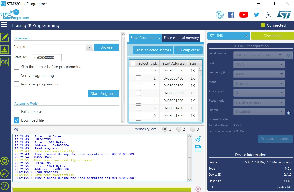

I have trouble with downloading code in MCU STM32F103 (Blue Pill) by ST-Link v2.
I have also try to download, read, erase MCU by STM32CubeProgrammer and it works correctly.
Project was made by STMCube as Atolic project and after that it was converted to STMCubeIDE project. Firmer, which is made by STMCubeIDE and downloaded in MCU by STMCubeProgrammer works as expected.

What if you first use CubeProgrammer to do a full chip erase, and then try to use CubeIDE with ST-LINK GDB-server to start a debug session (and thereby flash the application)?
Does that work?
BDimi
BDimiAuthor
August 21, 2019

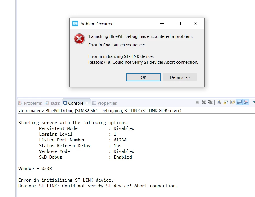

I've tried it one more time. Unfortunately without success. Please take a look on snippets form CubeIDE and Cube Programmer.
Version of CubeProgrammer is v2.1.0, CubeIDE is 1.0.2
mattias norlander
August 22, 2019
STM32CubeIDE works only with genuine STM32 parts.
Make sure that your BluePill board embeds a genuine STM32 device.

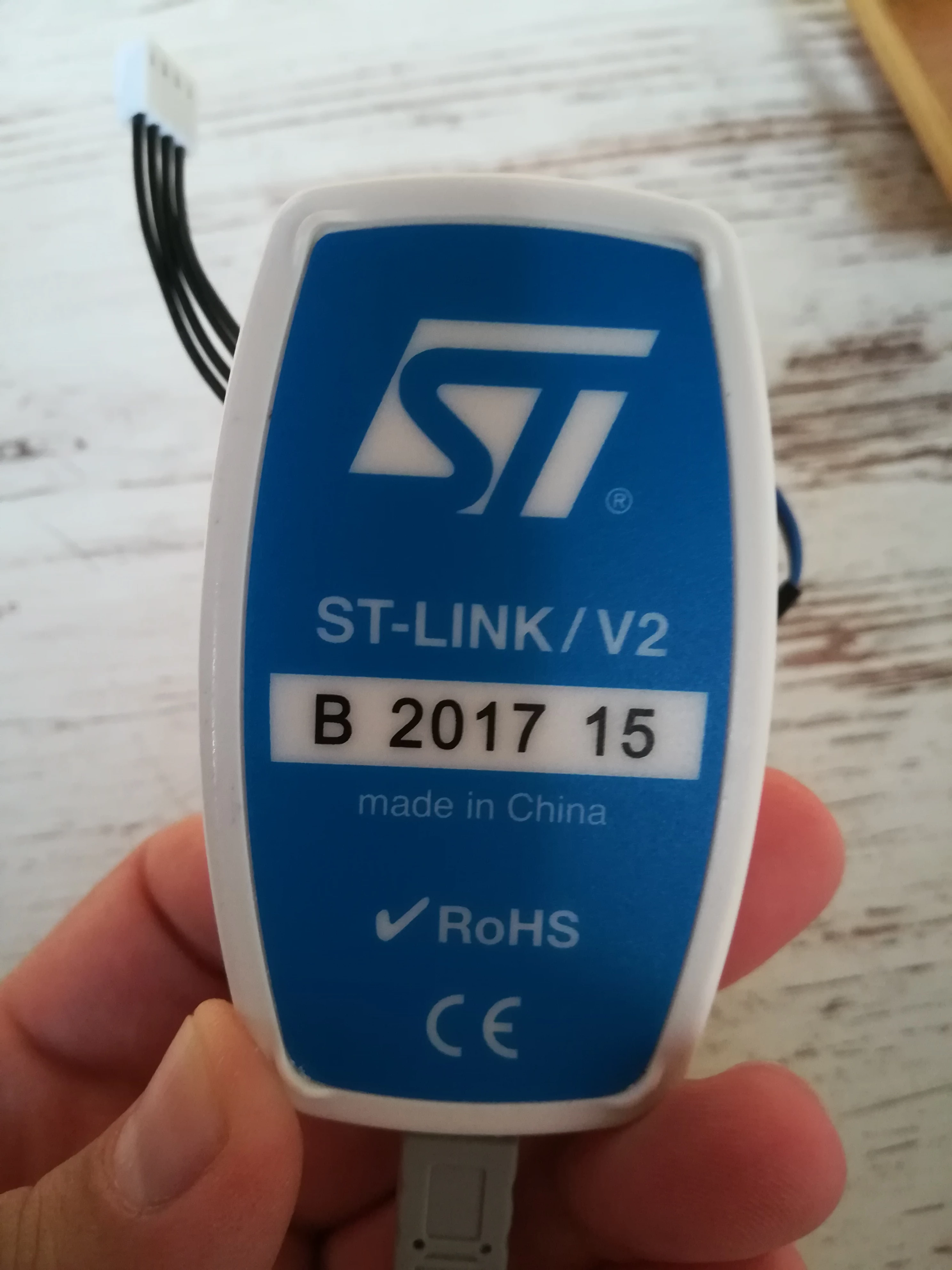

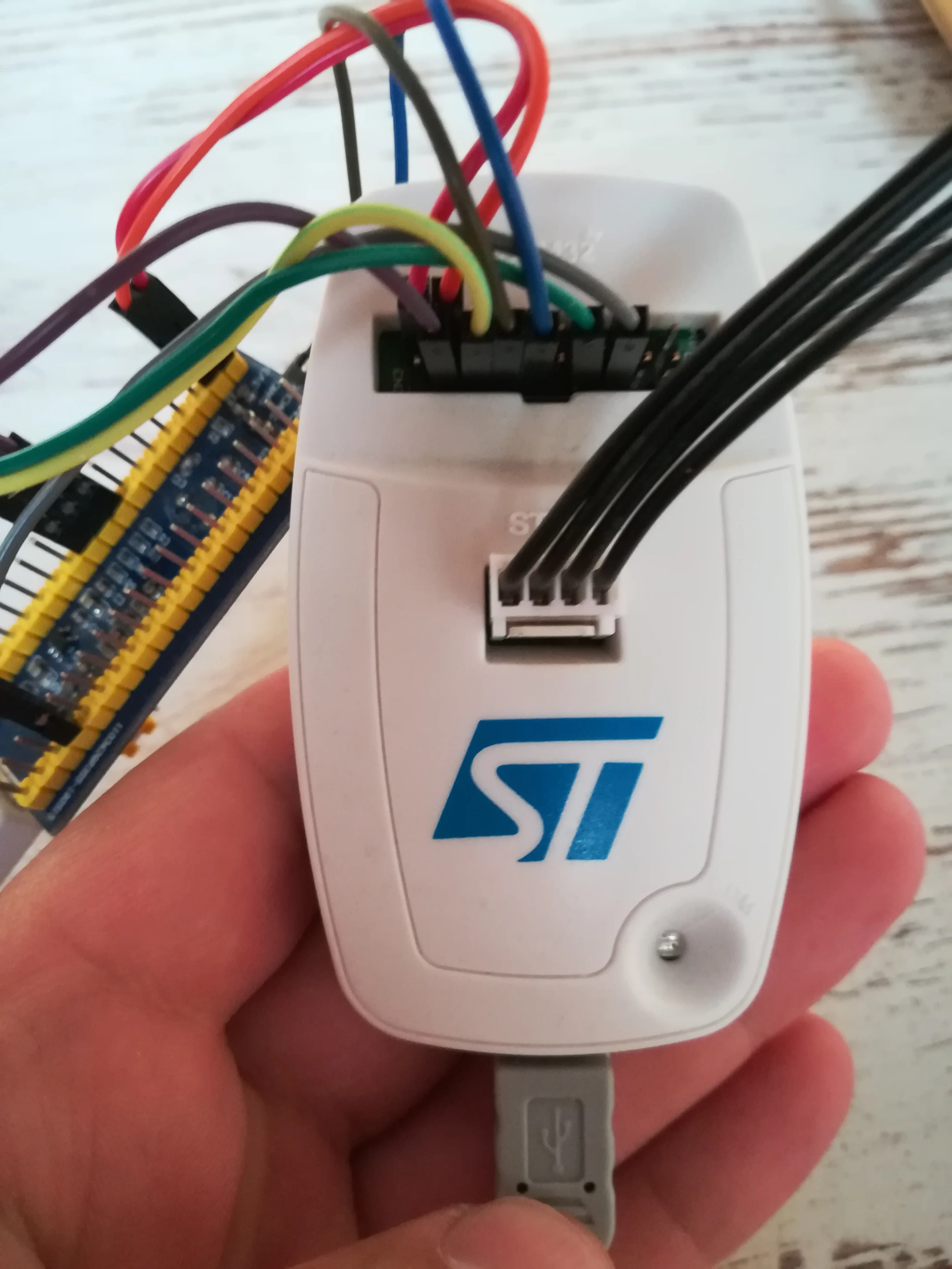

ST Link v2 is original STM product bought from famous distributor in EU. You can see picture below.
BluePill is bought on open market but MCU is origin STM product. I hope, I can not believe that there are "fake" STM MCU's on market.
From my point off view, it looks like that GDB - server can not establish connection with ST LInk. Why, I do not know. Also, I can not understand how CubeProgrammer can deal with that MCU but CubeIDE can not.
In meanwhile, I have tried to utilize JTAG but without success. I could use CubeProgrammer, but could not CubeIDE.

With similar problem, do you mean that you get the "Reason (18) Could not verify ST device. Abort connection." error?
Ac6 with OpenOCD debugger back-end did not perform the clone device detection. CubeIDE with ST-LINK GDB server does. So, assuming your bluepill embeds a cloned ST device, this is perfectly expected.
