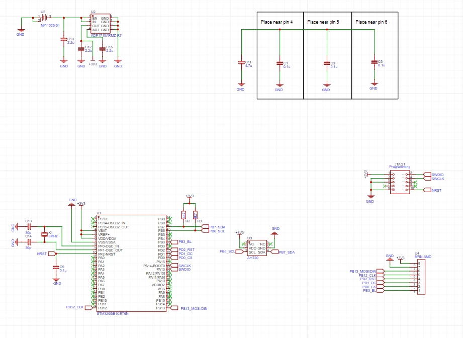

I have designed a custom board with the STM32G0B1CET6N but I cannot connect to the nucleo st-link programmer.
I have removed the two jumpers from the nucleo board but when connecting to the board it doesn't get recognised by the ST-Link Utility or STM32Programmer.
I do get an issue with the driver on the Device Manager but when I connect it to another custom board it works fine.
Below is the schematic for my custom board.
Any help is really appreciated.
Matteo

VDDIO2 and VSS on your must be connected too.
degausAuthor
November 17, 2024
Hello MM..1,
Thank you for your prompt reply!
Yes, I did noticed that mistake and I have put a temporary cable with the decoupling capacitors. Unfortunately it doesn't seem to work still. I will check that connection again in case there is a bad soldering.

If it fails so bad the ST-LINK drivers can't find it, you'd need to look at the circuit, for shorts, powering issues, etc.
Check part / connector orientations.

I am trying to understand what else I am missing, on top of the two connections that MM..1 has nicely pointed out.

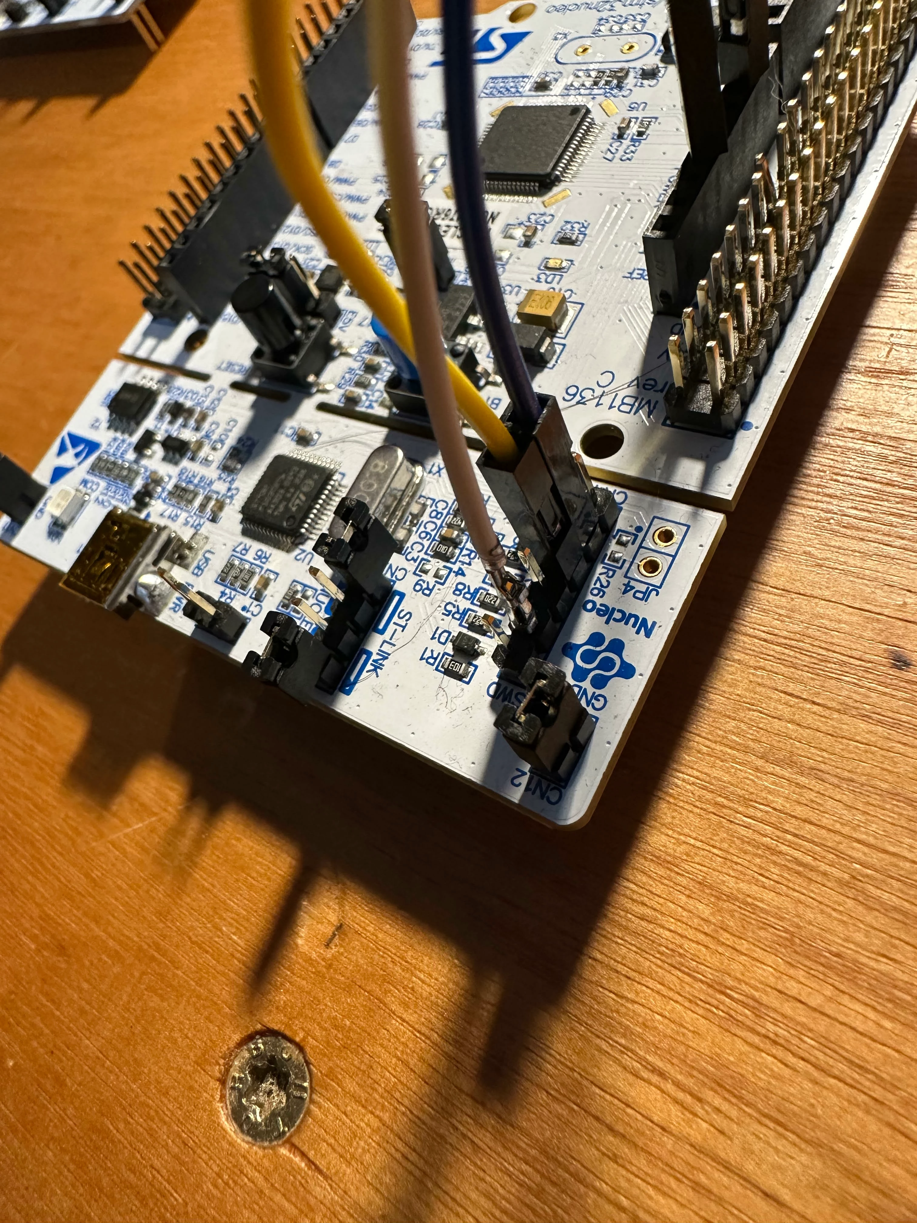

The link is working as normal with jumpers on, also it is working fine with jumpers off on another custom board (L010 chip). I have attached the picture with the jumpers off. I think I need to get a new board done with the VDDIO2 and VSS connected properly as the flying wire maybe are not connected properly. The board was factory assembled so I assume that is right.

For normal use you require three pins connected GND SWCLK SWDIO and on your image GND isnt connected
plus custom board power ...

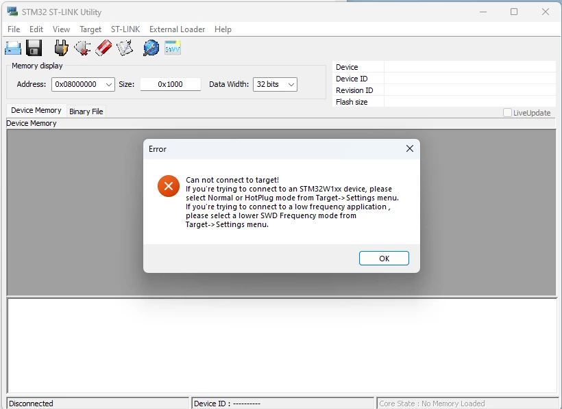

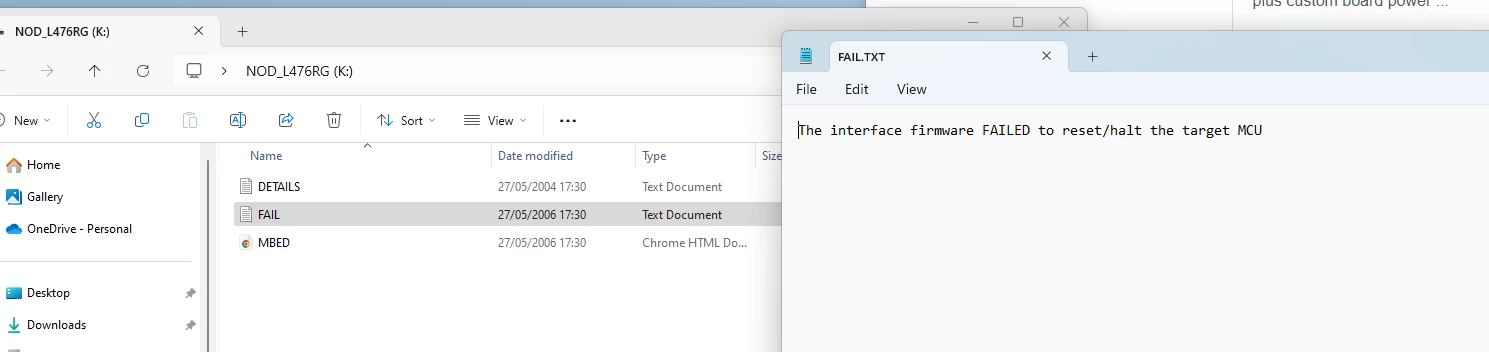

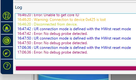

I have connected as your suggestion and now I do get a different error.
Need more investigation...I may get the board re-done with the VDDIO2 and VSS connected this time, just to make sure that the flying wires are not connected properly.
PS. Could you please let me know if I missed something else from schematic?
Thanks again.
Matteo
