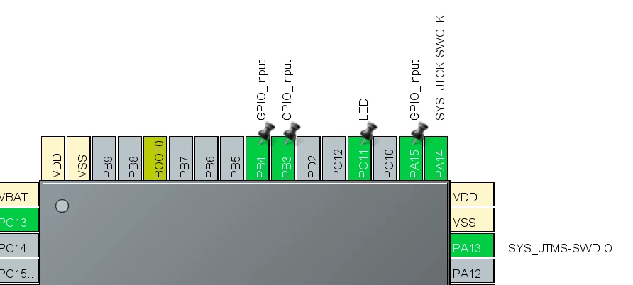

I have problems programing my custom board, I'm using a STM32F446RCT6, and I couldn't  establish a connection with my board, neither from STM32CubeIDE nor STM32CubeProgrammer.
after a lot of time trying to debug the problem I found out that actually I can establish a connection (an program) the board, but only if I'm pressing two very specific buttons.
The buttons were designed as general purpose buttons, but it seems they are connected to PB3 (JTDO) and PB4 (NJRST). We thought this pins could be configured as GPIO as well, but it seems something in the way those pins work is causing trouble.

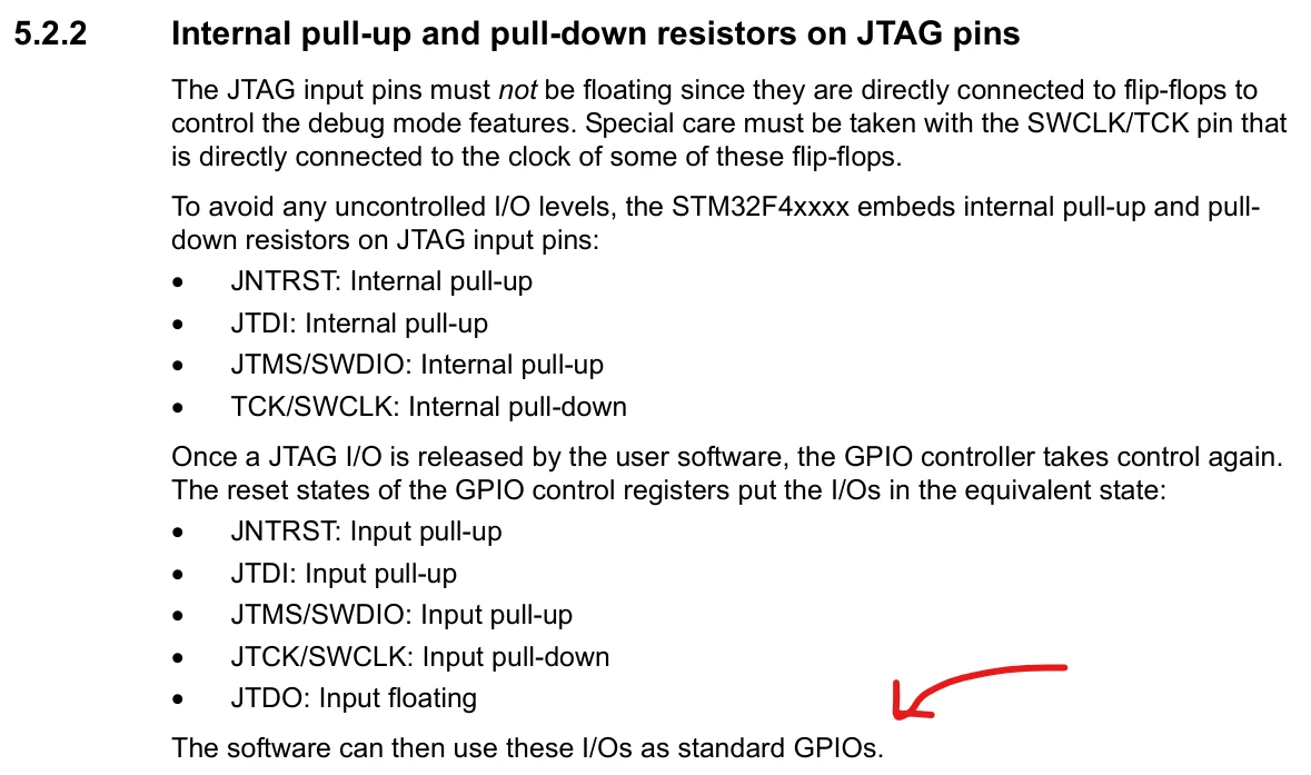

Thanks for the advice, I'm reading the AN4488:
It states that once JTAG is released by the user software, those pins can be used as GPIO's. But I can't achieve that on my board. I think my problem is that JNTRST is wired to 3.3V and JTDO/TRACESWO is wired to GND, so the board thinks those pins are not being released.
Is there a way to solve this from software?

As far as I know I'm not using JTAG; on STM32CubeIDE, on the SYS window it is selected SWD.

From the Reference Manual:
33.4.4 Using serial wire and releasing the unused debug pins as GPIOs
To use the serial wire DP to release some GPIOs, the user software must change the GPIO
(PA15, PB3 and PB4) configuration mode in the GPIO_MODER register. This releases
PA15, PB3 and PB4 which now become available as GPIOs.

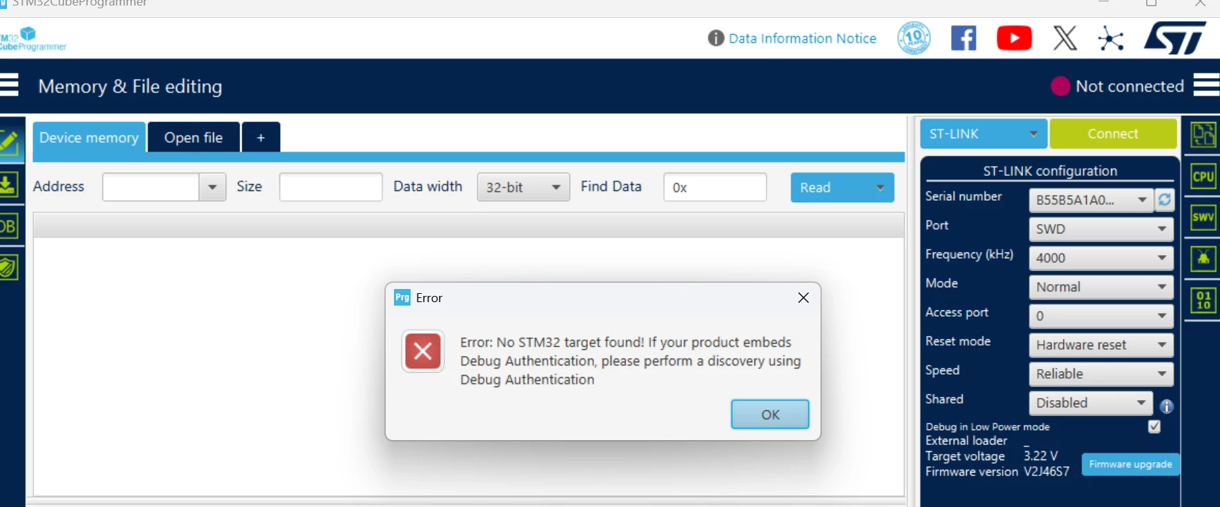

When I say that I cannot program my board what I mean is that, in STM32CubeProgramer I get this message when I try to connect:

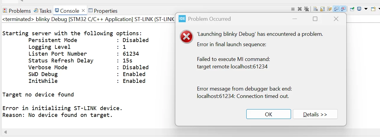

And that in STM32CubeIDE I get this message when I try to run debug:

Okay, maybe there is something I'm not understanding; I want to use only SWD, that's why I want to disable JTAG.
I wanted to change the configuration of PB3 and PB4 because I though that would solve the issue; but it seems it is not working.
Do you think this make sense? Maybe the problem is something else I don't see, but I though about PB4 and PB3, because the only way I was able to program or connect to the board was pressing the buttons connected with PB3 and PB4.

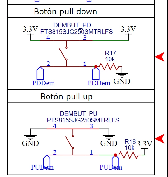

Normally your programming device / application has a configurable setting that you can specify SWD or JTAG, you should not have to do anything with the firmware to program the micro.
By "JTDO/TRACESWO is wired to GND" do you mean pulled down (through a resistor)?
This: "I can establish a connection (an program) the board, but only if I'm pressing two very specific buttons." sounds like an important clue.

Yes, (PB3) JTDO/TRACESWO is being pulled down through a 10k resistor and (PB4) NJTRST is being pulled up through a 10k resistor as well.
This is because we wanted to use those pins for general purpose buttons.
