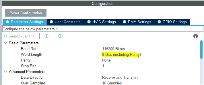

I'm working with a nucleo-L432kc board. I use a mac, VSC, Platformio and I use screen as a terminal. I used MXcube to setup a UART to use the VCP. MX cube generates the code. I have followed the instructions from several online sources to get it to work, but no luck seeing any output with "screen". I must be missing something fundamental. Does anyone have working sample code for this board I can look at to see what I'm doing wrong.

The only thing i can see wrong is that you have word length set for 7 bits instead of 8.

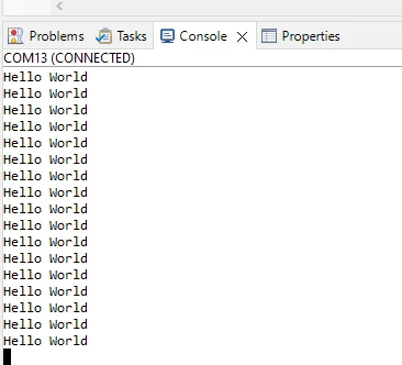

I'm using the same Nucleo-L432KC dev board, added the same code you have in main.c. This is the output i get.
Are you sure you have selected the correct COM port?

Show your code. Upload your IOC file.

I've attached the .ioc and main.c

I know serial com through the USB is possible. I can upload an Arduino Serial com sketch and screen on the Mac works fine.

I got the 7 bit thing from one of the many sites I looked at. I thought it odd, but I tried it. I'll double check the com port as you suggest.
Thanks for taking the time to verify my code. It helps a lot to know it can work.

So, changing the toolchain/IDE environment in STMCubeMX from EWARM ( the default ) to STMCubeIDE fixed the problem. I've been using "stm32pio" tools to convert CubeMX output to a Platfomio env. This user manual is out of date.
