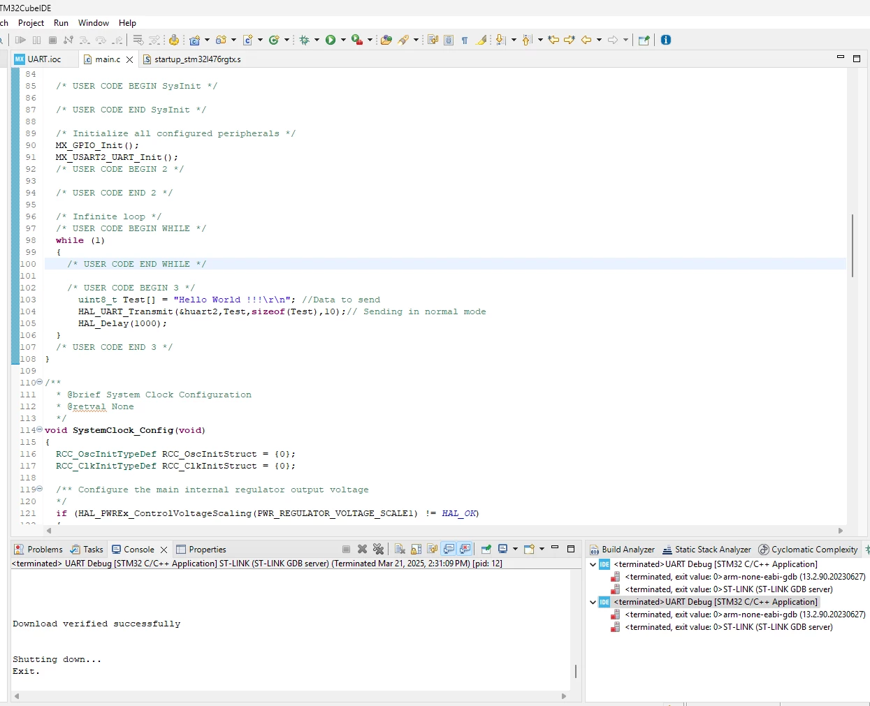

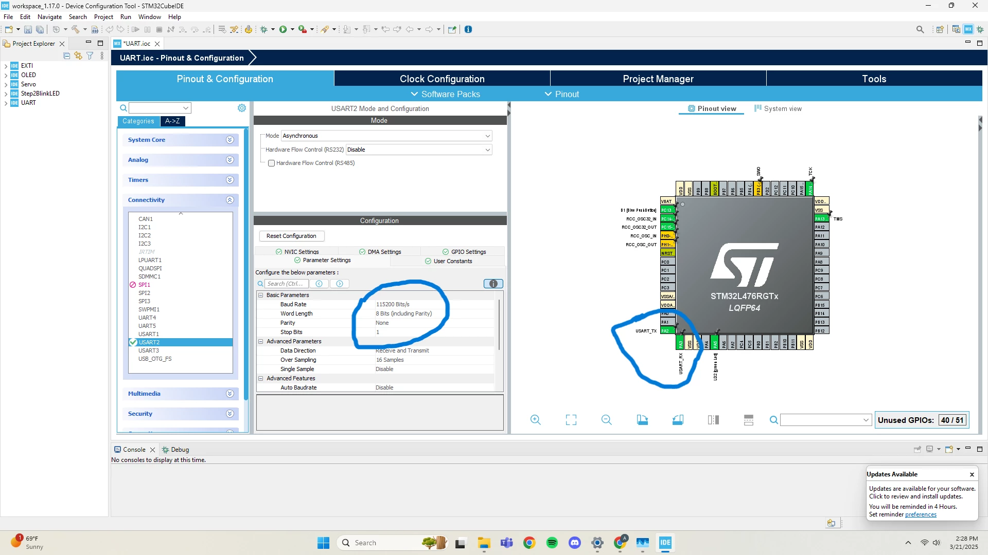

However, after building and running the project to my board as well as connecting it to Tera Term, output text is still not displaying in Tera Term. I configured my board by activating USART2 with matching default parameters as Tera Term, and is connected to PC through USB A-to-Mini B cable.Screenshot (3).pngScreenshot (4).pngScreenshot (5).pngScreenshot (6).pngScreenshot (7).png Does anyone have a solution? Thanks!

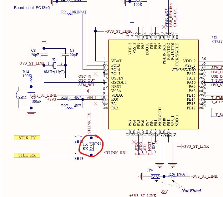

Check with an oscilloscope to see if the PA2 is transmitting. Then you can determine if it's on the STM32L476 side or VCP/Tera Term side that has an issue.
Another thing you can try is to do a loop back test on the VCP. Make sure the STM32 is erased else you won't be able to test the loop back. Place a jumper CN3. You should be able to send some text from Tera Term, and you should see text echo back.

minor thing: use strlen instead of sizeof.

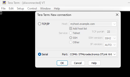

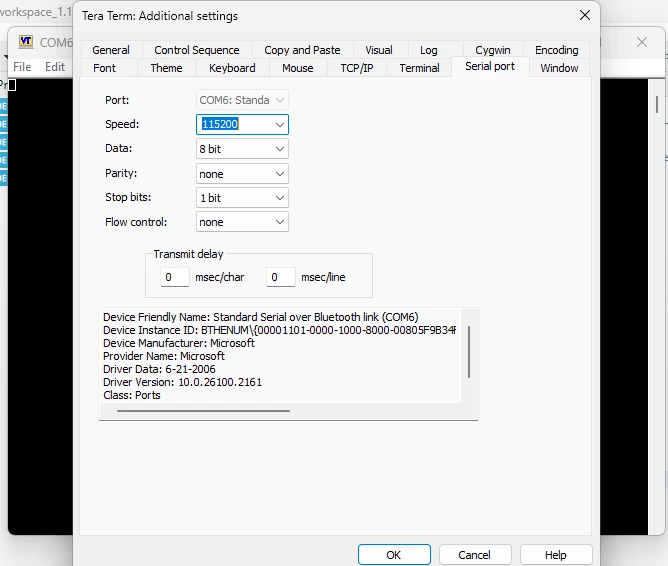

Double check the COM port number. In TeraTerm serial config dialog, the bottom panel should display "ST Microelectronics ..."; it doesn't - you are configuring another port in TeraTerm, not the Nucleo VCP.
