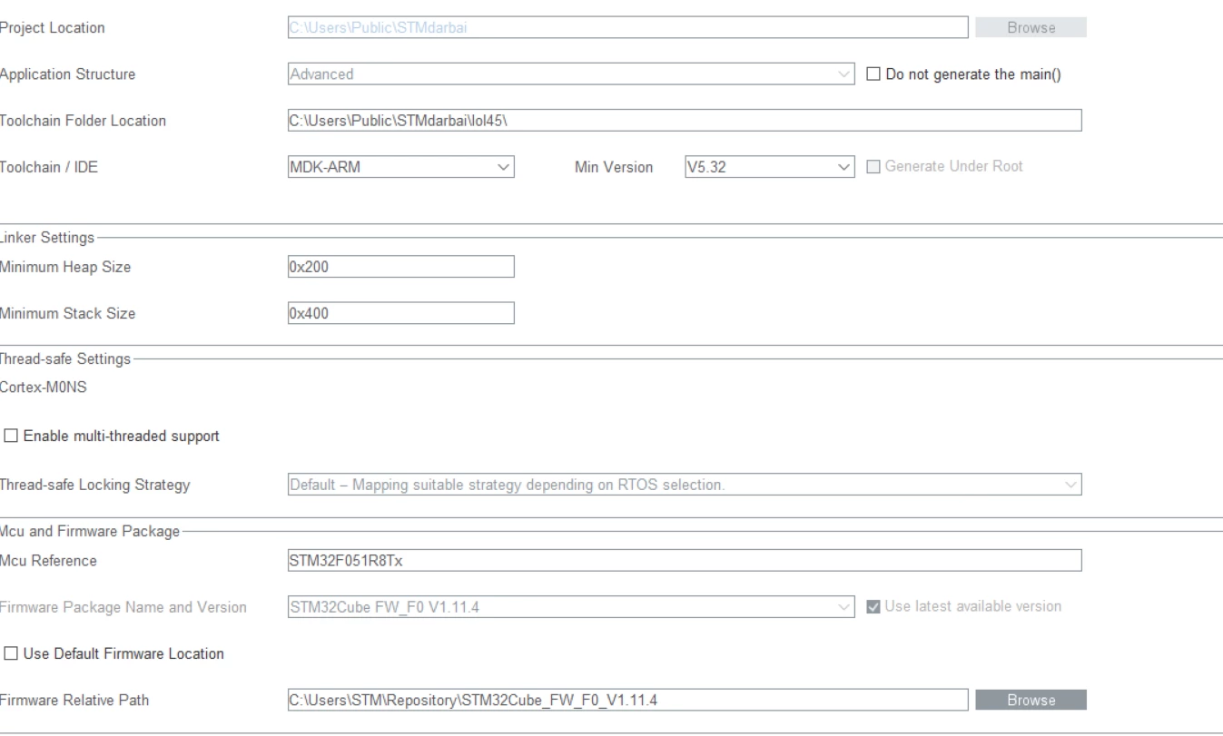

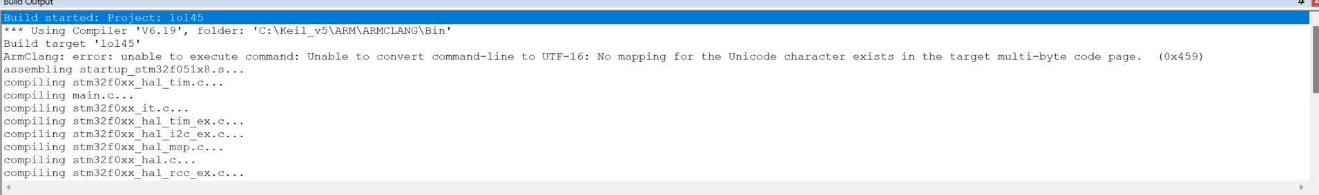

DžiugasAuthor
October 10, 2023
Ekrano kopija 2023-10-10 094443.pngEkrano kopija 2023-10-10 094527.pngEkrano kopija 2023-10-10 094627.png
