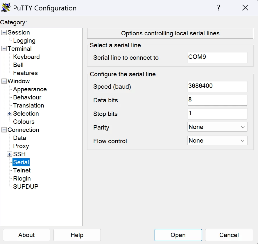

Mar 25, 2026 4:17 PM UTC
Thanks for your reply!
I can confirm the port is not in use by STM32CubeMonitor-Power when I try PuTTY.
Here are the settings I use:

Show a screenshot of your PuTTY settings - are you sure it supports that baud rate?
Mar 25, 2026 8:31 PM UTC
Here are my settings.
I also tried with lower rates, but same issue.

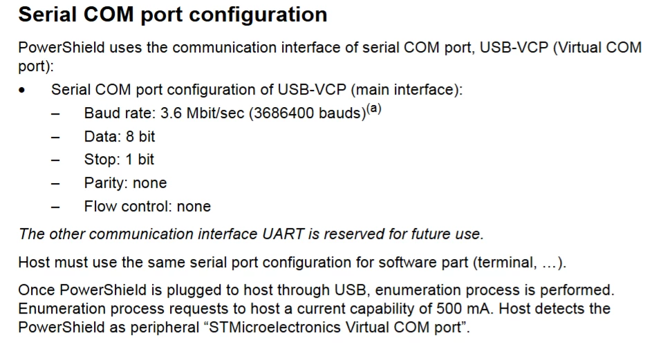

The documentation mentions the following: "On host USB virtual COM port, configuration of baud rate may be not needed since replaced by USB maximum baudrate"
