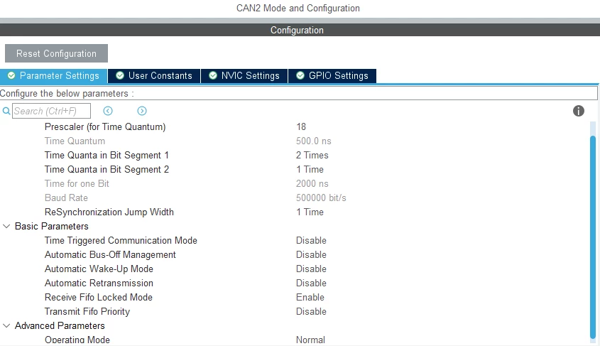

The problem that I am facing with the CAN communication using STM32F412G-DISCO  is that the CAN transmission from the STM32F412G-DISCO devboard is working fine, but the mcu is not receiving any data on the CAN bus. I am using a CAN analyser to send the data. I can confirm the analyser is properly sending the data since another mcu is receiving the data sent from my CAN analyser properly.
I have attached the code snippets am using to run the CAN RX and TX for review if anyone could let me know whether there is an issue in the code/configuration, or is it a problem of the device itself?
I am using the CAN2 peripheral and the application is running RTOS. The Baud of the CAN is 500Kbps.

            hcan2.Instance = CAN2;
            hcan2.Init.Prescaler = 18;
            hcan2.Init.Mode = CAN_MODE_NORMAL;
            hcan2.Init.SyncJumpWidth = CAN_SJW_1TQ;
            hcan2.Init.TimeSeg1 = CAN_BS1_2TQ;
            hcan2.Init.TimeSeg2 = CAN_BS2_1TQ;
            hcan2.Init.TimeTriggeredMode = DISABLE;
            hcan2.Init.AutoBusOff = DISABLE;
            hcan2.Init.AutoWakeUp = DISABLE;
            hcan2.Init.AutoRetransmission = DISABLE;
            hcan2.Init.ReceiveFifoLocked = ENABLE;
            hcan2.Init.TransmitFifoPriority = DISABLE;
            if (HAL_CAN_Init(&hcan2) != HAL_OK) {
                        Error_Handler();
            /* USER CODE BEGIN CAN2_Init 2 */
            /* USER CODE END CAN2_Init 2 */
I was checking the ‘datacheck’ variable but it always stays at 0. I have also tried putting a breakpoint in the callback, the control never hits the breakpoint. Which I am suspecting the callback never gets fired. I have tried without keeping the filter config, still no data received.
Are not a good settings. BS1 and BS2 are very low. So please decrease the prescaler as much as possible and increase BS1 and BS2 as much as possible in order to get the 500kb/s.
Suggestion: first try to allow all messages to be received by setting filterIDs to 0x0000.

I don't think it makes much of a difference in changing the prescaler, BS1 and B2 values as the CAN transmission is working fine.
However, I have also tried testing the CAN receive after changing the values to the following:
hcan2.Init.Prescaler = 4;
hcan2.Init.TimeSeg1 = CAN_BS1_9TQ;
hcan2.Init.TimeSeg2 = CAN_BS2_8TQ;
as well as tried by setting filterIDs to 0x0000.
But even after doing so, it is still not working.

"It does not make a difference" does not mean the recommendation I provided is not valid. I remember, in this community, people had CAN issues related to bad settings including low values of BS1 and BS2.
So now I suggest to:
- If  you are using HSI a source of clock, please use the STLink MCO instead.
- Start with Loop back mode to test your Filter config.  As I mentioned previously, start with filters config 0x0000.
- Check you connections and your HW including the transceiver/120ohm resistor
