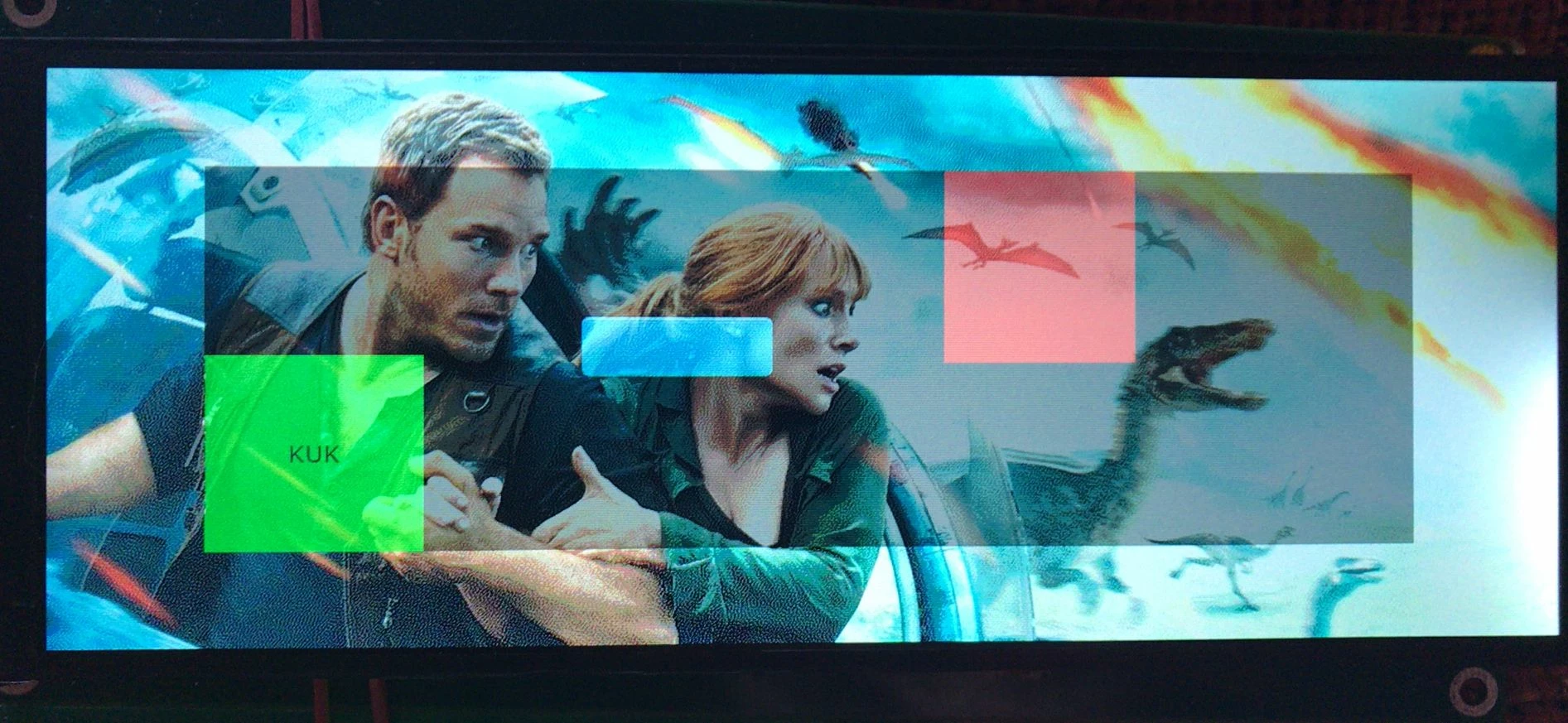

Try go back to start. You ask connect other pinout DSI to EVAL. Primary dont do it. DSI is suer high speed bus and require very perfect signal ways = every reduction ang long way is source for trouble.
For custom DSI create own custom board with STM and right connector.
Here one example 1280x480
