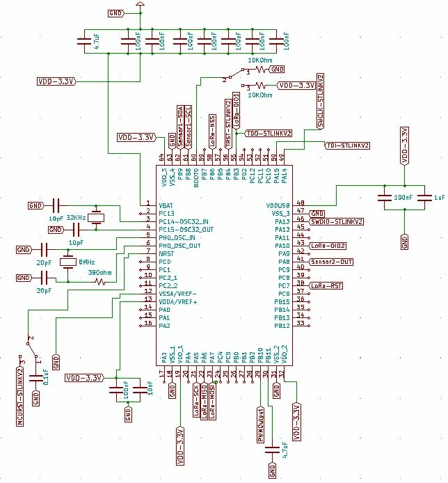

Can anyone here sincerely verify my schematic and let me know whether it'll work or not?
I'm mounting STM32L476RGT6U on PCB. For that, I have made this schematic. I need some expert suggestions from anyone who has in-depth knowledge of this. I'll use an ST-LINK V2 to debug and upload the program to the MCU on PCB.

That I have already seen and made it referring to that only. Rather, you can give your expert opinion, if any modification is required.

You have changed NRST circuitry. This is usually a "wired or", see ref. I wouldn't use a serial capacitor in the way you did. NRST is an IO pin.
Didn't look into more details.

Why do you think it wont work?
The schematic is only half of the information needed here, could you post PCB snapshots?

  1. Don't like reset circuit. The cap should always be connected. Switch parallel to cap, Personally I add room for an external pullup 10K (you don't have to populate it, but I do). I don't see a good reason to do your Reset different from development PCBs.
  2. VDD Caps: Better to arrange your decoupling Caps and other parts with GND downward. Caps at top with GND up is messy.
  3. PCB Layout of Decoupling Caps and Oscillators is critical. Do those first with minimal length traces. Target 0mm long, yup 0mm, though <10mm will work in most cases.
  4. Suggest separating VDDA/VSSA from VDD/VSS using 0ohm jumpers. That will force you to lay out those traces separately. Even if not critical in this design, it is just good proactice to keep analog and digital separate for future designs.
  5. Route VDD, GND, and all unused signals to a header(s). It sounds like you are making this as a base for several projects, so bringing these signals to accessible points may be useful. If thats not correct then you can ditch the header(s).
  6. Can't see where several signals go (I2C, STLINK, SPI, etc.) so can't evaluate those.
  7. Does LoRa = SPI? Is NSS same as SCC chip select? Didn't check if on correct pin. Useful to show MX setup of IC has matching pin definitions.
  8. Switches: You have switches on BOOT0 and NRST that can leave those pins open when in middle state - DON'T. Put a pullup/pulldown and have the switch pull the signal the other way. i.e. a Pullup with a switch to GND. You don't want your signal floating, even if the switch is only two position and spends little time between. Floating == RF Antenna == Unpredictable behaviour should the switch change slowly or become faulty or be unpopulated. A cheap pullup resistor will avoid all those cases.
  9. *I use STM32L476, order chips now, stock difficult to find during Covid.
