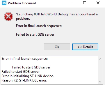

Can anyone help me about this ST Link_gdb server problem ?
Hello, i am new for using STM32 cube ide.
İ am following some online courses and when i was in debug part, i got this error :
i looked some solutions on google but , i couldn't fix this. What should i do ??

Looks like your stlink driver or​ stlink gdb server are not working properly. Reinstall stlink drivers, update stlink firmware, restart your pc and try again

Can STM32CubeProgrammer connect to the device? Did you reboot? Power cycle the debugger?

i did reboot, but i don't have any board , i mean any usb device for pc.
Should i buy board like stm32fdiscovery to test my codes ?
Jul 25, 2020 6:27 PM UTC
Well you need a debugger to program efficiently. Most ST boards have them built in. What board do you have? If none, then you need one.
