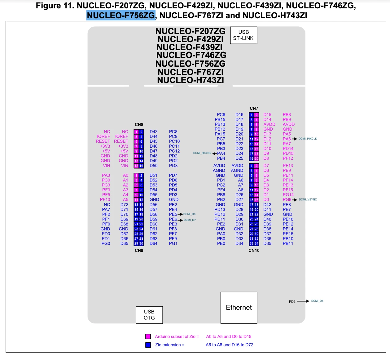

Dear all,
I would like to connect a camera to my Nucleo F756ZG board, with the goal to send images via the ethernet port. However, this board doesn't feature a 30-pin ZIF connector nor a 22‑pin FFC connector....
  • Apparently, the STM32 F756ZG has a "DCMI". Is this accessible on the Nucleo board as well?
  • Which module/camera do you recommend for the Nucleo F756ZG?
  • Would you recommend Arducam? They seem suspiciously cheap
  • The B-CAMS-IMX is not compatible, right?
Many thanks

First of all you need to refer to STM32F756 datasheet and check all required pins for camera module (DCMI_PIXCLK, DCMI_HSYNC,  DCMI_D0.....) are supported or not in STM32F756. If yes, you can use jumper wire to connect camera module CN4 pins with desired pins in Nucleo board by referring to UM1974 Figure11.
For example, you can find DCMI_PIXCLK on PA6

LysAnAuthor
Feb 3, 2026 10:05 AM UTC
Hello Kaouthar,
thanks for your thorough guidance on this.
In the STM32F6 datasheet I found all pins required for the camera. And most of these pins also appear in the extension connectors of the Nucleo-F756ZG board (see image).
However, in the STM32F6 the pin DCMI_D0 is linked to PH9, which strangely doesn't show up anywhere in the Nucleo-F756ZG...Is this an indication, that I should use the alternate pin PC6 with this particular board?
