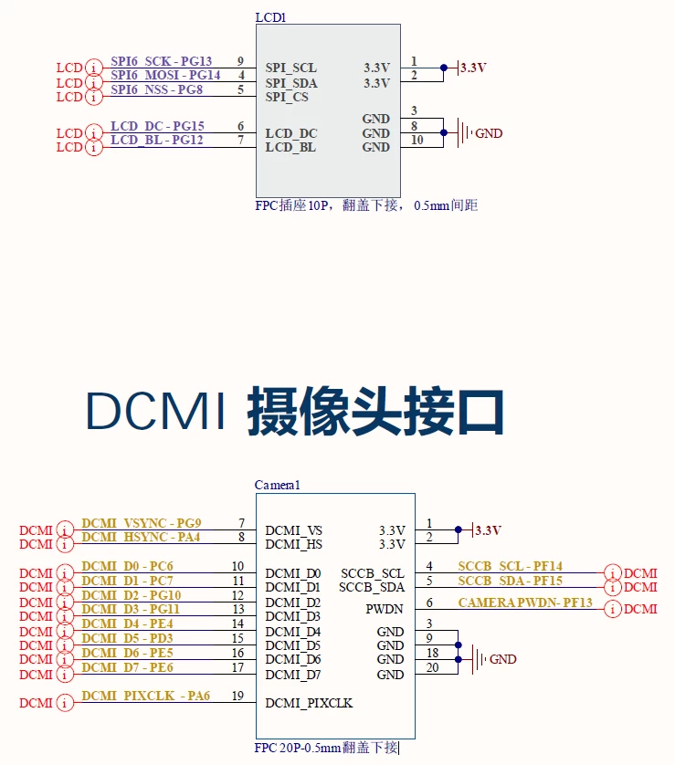

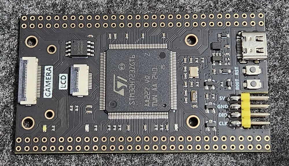

I purchased this STM32H723 mini core board that has 20 pin fpc connector for camera module and 10 pin fpc connector for LCD module.

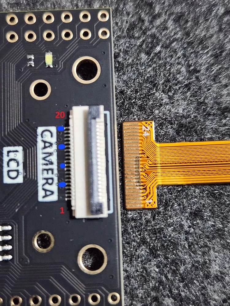

I purchased OV2640, but it turned out to have 24 pin cable.
I have 3 questions:
  1. Is there an adapter solution for this ?
  2. What camera module will fit this board, please provide Aliexpress product link if possible.
  3. What LCD module I can connect to this board ?

You need to contact the board's manufacturer as the connectors' pinouts are fixed. Meanwhile this is a list of camera modules that can be used in our boards (from AN5020):
According to the schematics, you need an LCD with SPI or I2C interface but again the connectors' pinouts are fixed.
Again you need to check with board's manufacturer.

Yep, I think I'll eventually develop my custom SPI/I2C interface to connect LCD with FFC cable.

Hi .. I got it from the seller.
That's the best they could help me with. I'm trying to develop a way to run the camera using adapter board for 20 pins then I hope to find a library for the camera using SPI if things worked as expected.
