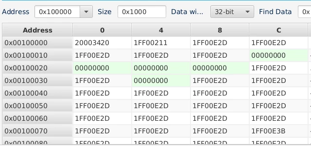

The board is MB1225-F769I-B03 with the MB1166 Rev A display board.
It appears when connecting it to STM32CubeProgrammer and I can read the memory out of it seemingly.
0x00000000 is 0x58306F8E (I can read up to 0x3FFF fine)
0x00100000 starts 0x20003420 (see attached) which is BOOT_ADD1
0x00200000 is just 0xFFFFFFFF which is BOOT_ADD0
0x80000000 is 0x00000000
0x90000000 is also 0x00000000
Is there a hex file for the default application which I can flash onto the device just to check it works before adding in the unknowns of getting my build environment setup?
WolAuthor
July 7, 2023
Also to add, that BOOT0 seems to be low on the board according to the schematic, so I'm not sure if it's trying to boot from 0x00200000 which doesn't have anything at it?

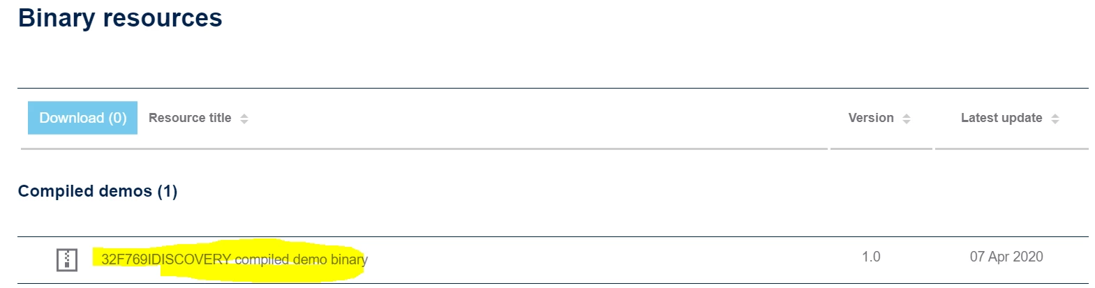

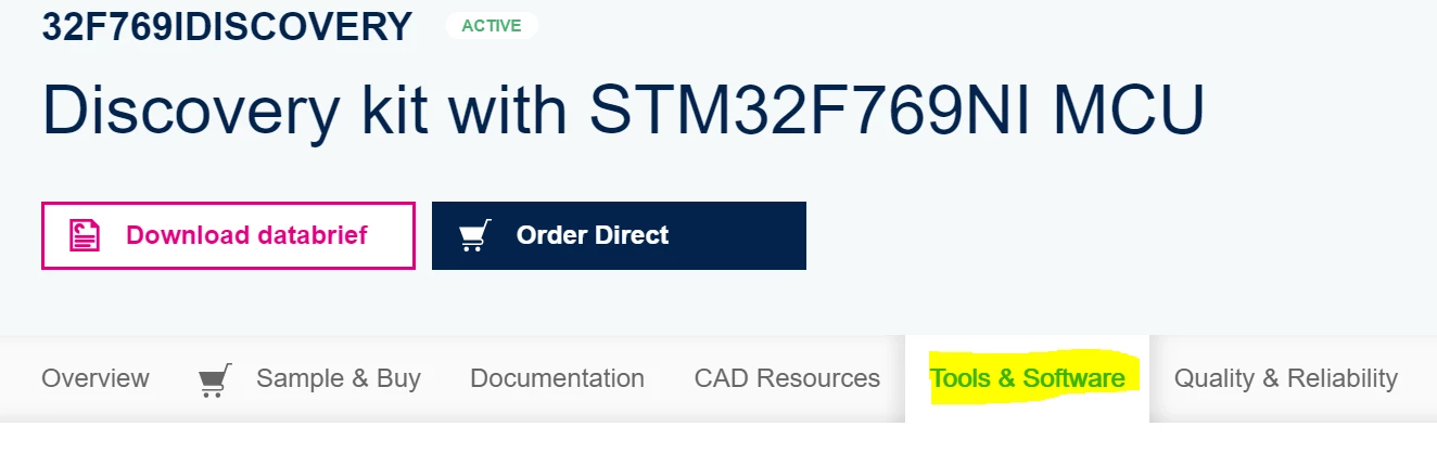

Hi @Wol ,
Sorry for the delay, I tried to reply directly on this post but due to size constraint I could not add the binaries files.
Here is how to download them :
  - Please refer to the : https://www.st.com/en/evaluation-tools/32f769idiscovery.html#
  - Go to "Tools & Software"
 - At the end of the page you will find "Binary resources" and the "compiled demos"
Best regards,
Aime

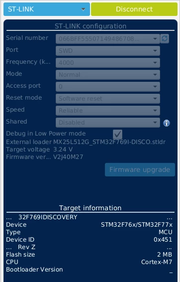

Thanks for the link! Have managed to download that and followed the readme provided to enable the external loader for the board, erase the internal and external flash, and now the board at least boots up and displays the "life augmented" tagline and the ST logo on the display, but that's as far as the demo gets and nothing happens further. Tapping the screen doesn't get anything, and the user button doesn't do anything.
The hex file seemed to program okay and then verify successfully too:
11:23:01 : Memory Programming ...
 11:23:01 : Opening and parsing file: STM32769I-DISCO_DEMO_V1.0.0_FULL.hex
 11:23:02 : File : STM32769I-DISCO_DEMO_V1.0.0_FULL.hex
 11:23:02 : Size : 43607875 Bytes
 11:23:02 : Address : 0x08000000
 11:23:02 : Erasing memory corresponding to segment 0:
 11:23:02 : Erasing internal memory sectors [0 6]
 11:23:05 : Erasing memory corresponding to segment 1:
 11:23:05 : Erasing internal memory sectors [8 9]
 11:23:07 : Erasing memory corresponding to segment 2:
 11:23:07 : Erasing internal memory sectors [10 11]
 11:23:09 : Erasing memory corresponding to segment 3:
 11:23:09 : Erasing external memory sectors [0 130]
 11:23:29 : Erasing memory corresponding to segment 4:
 11:23:29 : Erasing external memory sectors [256 714]
 11:24:37 : Erasing memory corresponding to segment 5:
 11:24:37 : Erasing external memory sectors [768 818]
 11:24:45 : Download in Progress:
 11:29:40 : File download complete
 11:29:40 : Time elapsed during download operation: 00:06:38.290
 11:29:40 : Verifying ...
 11:29:40 : Read progress:
 11:34:29 : Download verified successfully
 11:34:29 : RUNNING Program ...
 11:34:29 : Address: : 0x08000000
 11:34:29 : Application is running, Please Hold on...
 11:34:29 : Start operation achieved successfully
 This is the info about the target board in STM32CubeProgrammer which all looks okay to me. Annoyingly the UI hides some of the text behind "..."s. It shows that the external loader is there and it's found the parts okay.
The readme did say that for the media demos that I need to connect a USB stick with the provided media files on it, but I've had another dev kit board which still boots into the usual list of apps without needing this plugged in.
Are there any steps I'm missing in getting this board to work? Even doing a full chip erase first doesn't seem to have changed anything either.
