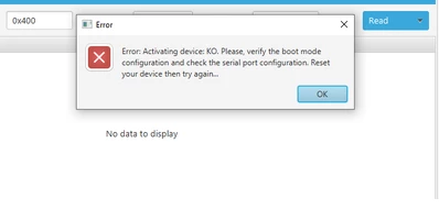

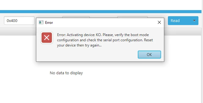

I'm encountering a problem transferring a bin file via UART on my Stm32f103c8t6. While UART3 functions correctly with a USB TTL converter, UART1 doesn't seem to establish a connection.
  • I've verified the connections between the device's UART1 pins (TX and RX) and the USB TTL converter.
  • I'm using the appropriate baud rate settings on both the device and the terminal software.snehadakhare01_0-1718184993732.png

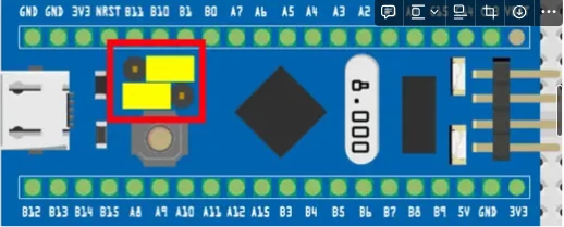

Hello @snehadakhare01 ,
Make sure that BOOT0 is High.
Check that you are properly connecting the pins supported by the bootloader, as described in AN2606 STM32 microcontroller system memory boot mode - Application note.

Bootloader status was set like this
When TTL Rx and TX are connect to PA9 and PA10 (UART3) it is working
But I  want to connect TX and RX to PB6 and PB7(UART1) of Bluepill that time it is showing error
Connection
                    TTL                         Bluepill
                  TX                           PB7(Rx)
                  RX                           PB6(Tx)
                  VCC=3.3                            VCC=3.3
                 GND                           GND
