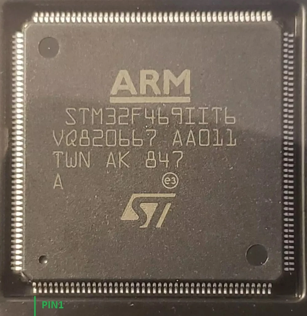

Hi! I am new in electronics, but I am trying to design my PCB using STM32F469IIT6. I did a similar project before using a simple atmega168, but the STM32 seems way more complex. I wonder what the minimum of hardware connection is I need to be able to BOOT or even detect the target using my ST-LINK. Right now, I powered all VDD pins and VDDA pins, as well connected all the GND pins. I set up pins 137-SWCLK and 128-SWDIO in my IDE, connected the ST-LINK, but it does not find the target. I wish someone could give me a help.

Hi! I've been following the diagrams, they really help! I bought an adapter, where I then soldered the MCU to be able to kind of work in the breadboard. I wired the pins in the diagram, but the ST-link did not find the target. I also got another ST-LINK as Peter suggested, and I thinking in manufacture one version, for I am wondering if the distance of the capacitors from the VDD pins are one of the reasons for my constant failure. I will post the schematic I have so far. Thank you very much!

Check part orientation
Check voltage present on VCAP pin, and capacitors
Check voltage observed on NRST pin
Provide a schematic, constrained to the STM32 if that's simpler, so we can better understand what you've built.
A large, clear and in-focus picture of the board with the part in-situ will also be illustrative.
The ST-LINK expects to see a target voltage on pin 1 or 2 of the standard JTAG 20-pin connector.

Thread then went here  https://community.st.com/t5/stm32-mcus-products/booting-stm32f469/td-p/759281
Sounds like an orientation issue
