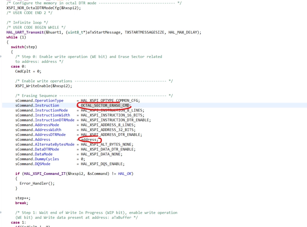

I am currently using STM32N6657XOHXQ(Discovery Kit), I am running the (XSPI_NOR_MemoryMapped_DTR) example from STM32CubeMX. I have added UART print to debug the issue. Below are steps to reproduce the issue I am seeing.
1. Put the board in development board (BOOT1 Switch position 1-3, BOOT0 Switch Position 1-2)
For flashing external memory.
2. Ran the exe.
3. Open STM32CubeProgrammer and open erasing and programming tab.

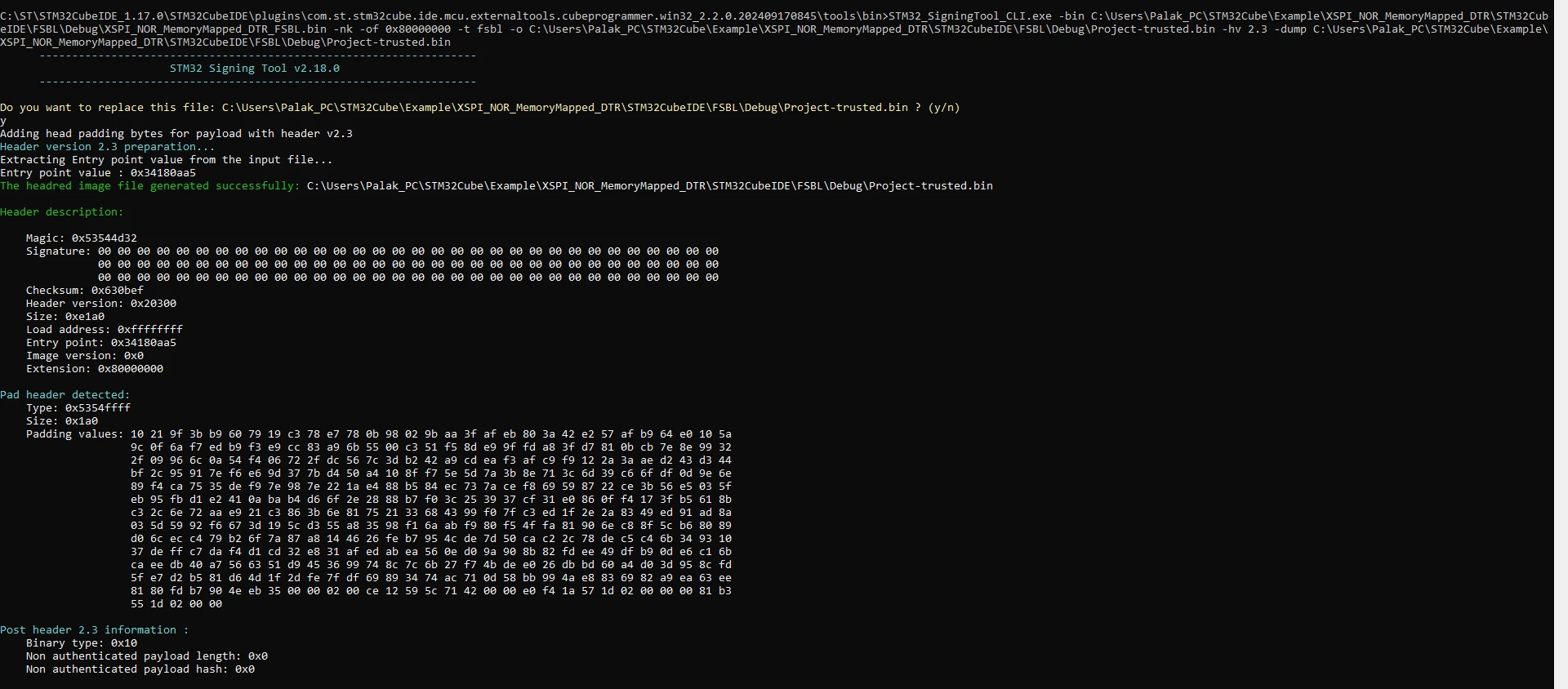

4. Select the project-trusted.bin then select "Verify Programming"
5. Select "Download file" and write "-cb" in "Option Bytes Command"
6. Select Erase External Memory and then click on "start programming".
6. Put the board in boot mode (BOOT1 Switch position 1-2, BOOT0 Switch Position 1-2)
7. Press Reset Button.
When the code is flashing first time it works, Green LED Blinks and UART Output is attached below.
8. But when reset button is pressed again it doesn't generate output as above..
I have attached my code in which UART is added to verify board boot status.

Hello!
The first time, your FSBL code is loaded in AXISRAM and it is executed correctlyt
In your code after configuring the Octoflash you are erasing the sector where the FSBL (sector 0) is loaded.
That's why in the next reset the Bootrom can't find any FSBL code in the flash to load and run in AXISRAM.
Hope that will help
Best regards
ANJS
