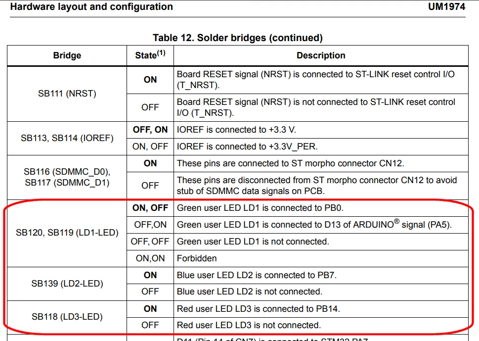

I want to let the user LEDs blinken, however it is not working. When I run the code the LD4(COM) is blinking red and green. after the run the LD4(COM) is red the whole time and the user LEDs do not blink. Should the LD4(COM) be lighting green?

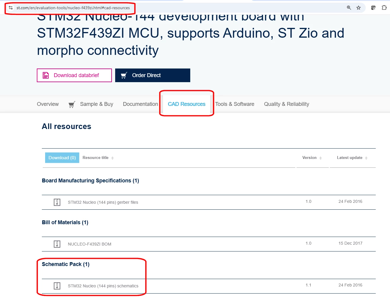

@ap44 wrote:
Could you maybe tell me where I can find the pin-configuration for my Board STM32- nucleo-f439ZI. I went through the whole user-manual but could not find it
here:
https://www.st.com/resource/en/user_manual/um1974-stm32-nucleo144-boards-mb1137-stmicroelectronics.pdf#page=24
also here:
@ap44 wrote:
 there is no CAD-documentation for this board
It's here:
https://www.st.com/en/evaluation-tools/nucleo-f439zi.html#cad-resources

ap44Author
Jul 14, 2025 6:45 AM UTC
Hi, thank you for your answer!
My Board has not been modified in any way.
right now I am trying to get the example which was posted in my question running. I modified the code accordingly, the I built (the hammer-icon) and the I run it, afterwards i press the buttons on my nucleo but it does not work.

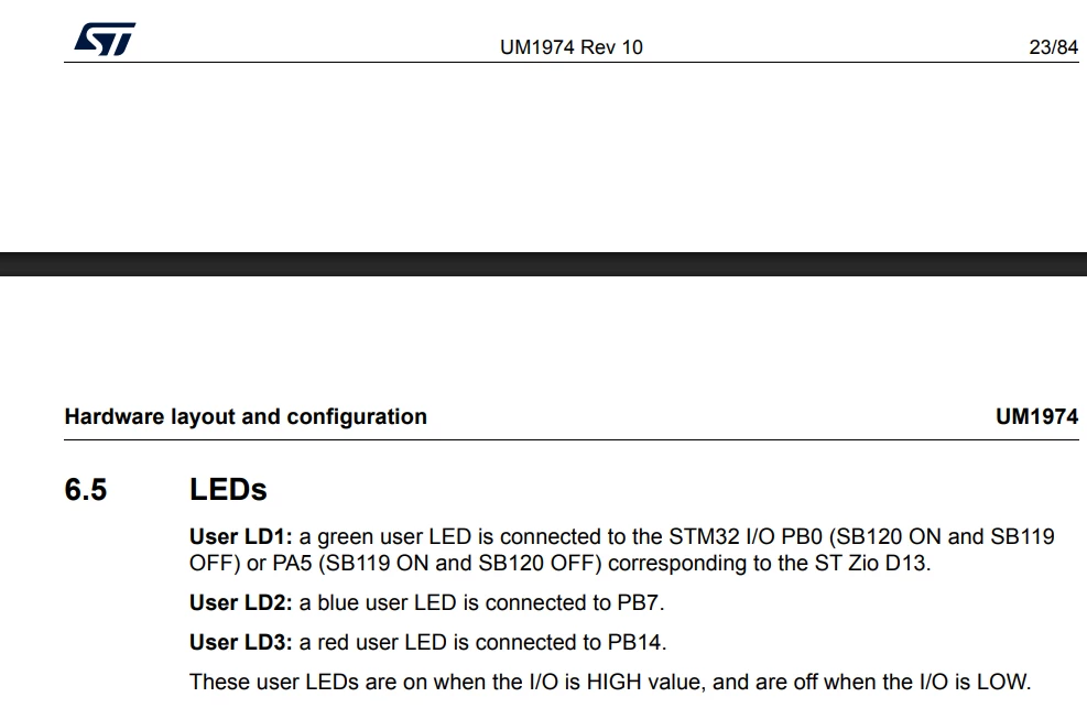

Jul 11, 2025 11:18 AM UTC
LD4 should be solid red when the program is running. It will be flashing during programming or while debug is active.
ap44Author
Jul 14, 2025 9:10 AM UTC
It is now working with this code, so my red LED is blinking, before I tried to let the green blink. Now I switched to the red using Pin PB14, so maybe the Pin I tried to use for the green one was wrong. I tried to use Pin PA5. Could you maybe tell me where I can find the pin-configuration for my Board STM32- nucleo-f439ZI. I went through the whole user-manual but could not find it and there is no CAD-documentation for this board or at least I could not find it.

mƎALLEm
Jul 14, 2025 9:26 AM UTC
From the user manual of the board:
