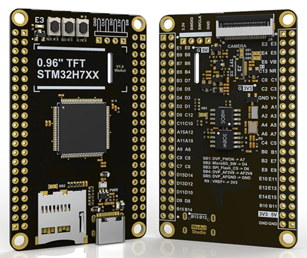

    ARobo
    ARoboAuthor
    September 14, 2021
    Hi I’ve been doing some more research specifically looking at the NUCLEO boards and it looks like they don’t have a dedicated dsi connector to add displays. I think the shield you mentioned is something like this, but I’m not sure I’d access the rest of the io pins with it installed.
    I took a look at the STM32F7508-DK which comes with a dedicated display but it io (serial/digital pins) seems very limited.
    The we act studioboard seems cool but I’m not sure if it build it display connection would work with a touch screen.
    Do you know if there’s a STM32 board that works straightforward with a tft touchscreen (online it seems people have had trouble interfacing standard tft touchscreens with the STM 32s) + has lots of io + is also lower cost?
