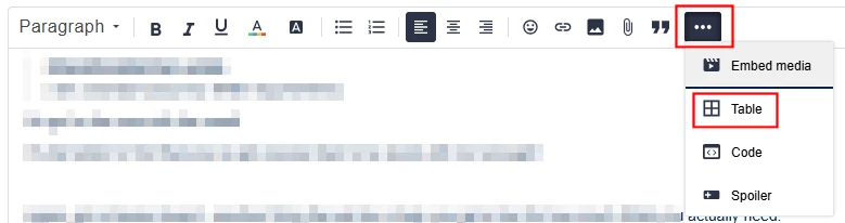

Sorry, I don’t fancy downloading an .xlsx - you can make a table in the forum editor:
