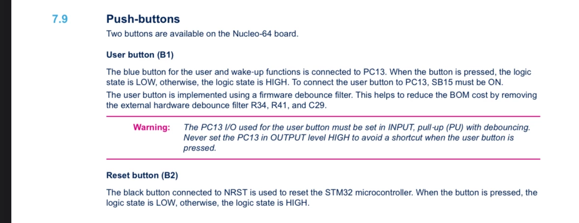

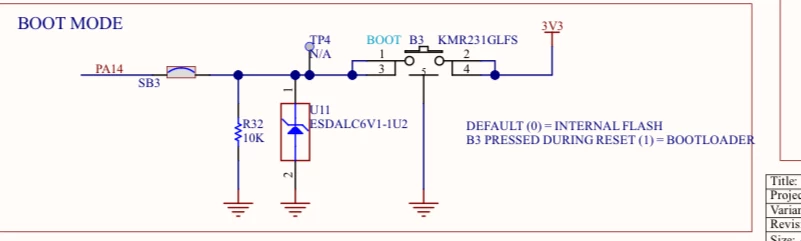

B3 on the NUCLEO-C092RC is not mentioned on the UM3353

on the MB2046 schematic, there is a button called B3 or Boot mode pin:
But the UM3353 (chapter 7.9) mention only B1 and B2:
Could you please correct this on the coming doc revisions.

You are right ! The function for B3 Boot mode is missing description in UM3353.
An internal ticket ID 220601 is submitted in order to correct this.

Hi @Issamos
The UM3353 is now updated and published with correction.
