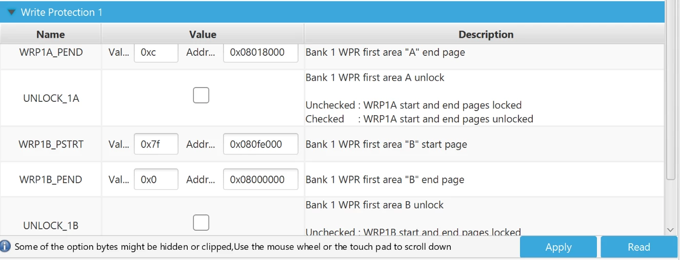

 Now when connecting and doing a full chip erase i am getting erase message:
i feel the issue is at the UNLOCK1A,1B,2A,2B bit checking
I am not able to check this box getting error message
As a result of which i am unable to test any sample program or debug. is the flash memory locked -Please help me solve this issue.
I am also not able to do the full chip erase option. it displays the following error message.
how to permanently unlock the flash memory. Please suggest.
