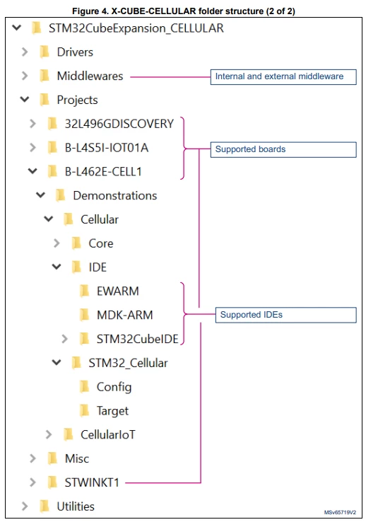

However in the UM2426 User Manual, this Figure is shown:
Which states, that the "Cellular" Example is inside the X-CUBE-CELLULAR expansion... but it isnt. If you download it, only the "Nx_TCP_Echo_Client" is in there.
Do I have to merge the two folders? Can I install examples via the CubeIDE?

Hello @Chani and welcome to the Community:) ,
You can find the demonstration examples shared in the user Manual in X-Cube-Cellular version 6.0.0 :
-Cellular demo in en.x-cube-cellular_v6-0-0.zip\STM32CubeExpansion_CELLULAR_V6.0.0\Projects\B-L462E-CELL1\Demonstrations\Cellular\
- CellularIOT demo in en.x-cube-cellular_v6-0-0.zip\STM32CubeExpansion_CELLULAR_V6.0.0\Projects\B-L462E-CELL1\Demonstrations\CellularIoT\

I merged the STM32CubeExpansion_CELLULAR_FreeRTOS_V7.1.0 and STM32CubeExpansion_CELLULAR_V7.1.0 folders and compiled the Projects\B-L462E-CELL1\Demonstrations\CellularIoT sucessfully with the CubeIDE. However, I will also try with Version 6.0.0.

Hello Chani,
How to add FreeRTOS support to Azure RTOS package
The main idea is to download an add-on and to apply it over XCC (based on Azure RTOS).
It adds all the required files to get Cellular using FreeRTOS / LwIP up & running.
Both X-CUBE-CELLULAR, delivery are based on Azure RTOS and XCC_FreeRTOS, add-on to add FreeRTOS support are available on www.st.com.
Once X-CUBE-CELLULAR is extracted, only Azure RTOS is available. To add new needed middlewares (FreeRTOS and LwIP) and FreeRTOS examples, users must extract XCC_FreeRTOS over X-CUBE-CELLULAR.
Thus, new middlewares, BSP for B-L462I-CELL1 board and FreeRTOS based "Demonstrations" are added. All Azure RTOS parts remain available.
Once done you can choose an Azure or FreeRTOS example.
