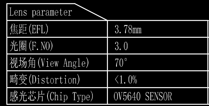

What is the lens used on the B-CAMS-OMV kit?  Or, what is the field of view?  or, what is the focal length?

The camera module part number is HDF5640-AF-V2.0 on B-CAMS-OMV.  Pls. find lens parameter below.

mikepangAuthor
Jul 23, 2025 1:01 PM UTC
Many thanks!  That's what I'm looking for!
