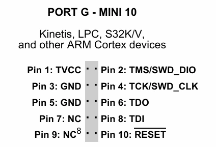

ARM Debug probe with power to target capability
I have been using PE micro Multilink FX for several years, but its Linux support is terrible. Is there a ST (or another) alternative with this functionality compatible with stm32CubeIDE? I just need to supply power (up to 100 mA at 3.3V) to my board for debugging. I don't need high tracing performance or anything like that.

No, this isn't available on any ST-Link programmers. Pin 1 is always an input.
You could either modify the programmer hardware to short pin 1 to 3.3V, or you could use power on the 20-pin connector. But the functionality you want is not available on an ST programmers without hardware modification.

No. I need supply power 3.3V through 10-pin connector along SWDIO, SWCLK and RESET signals.
STLINK-V3PWR supply power through a separate connector instead.
Power is not supplied in the standard 10-pin ARM debug header. All ST programmers adhere to the standard and do not supply power on a 10-pin connector.
https://documentation-service.arm.com/static/5fce6c49e167456a35b36af1
It doesn't look like the 10-pin header on the PE micro Multilink FX is any different. What pinout are you using that you want to duplicate functionality?
The st-link v2 has a 20-pin connector with 3.3V power supplied on pin 19. That's the closest you'll get.

You just need to supply power through pin1, as we have been discussing.
