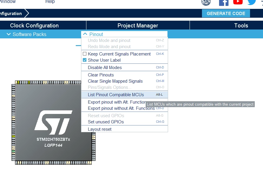

You can use CubeMX to select the list of the MCUs which are compatible and compare the pins, through "List Pinout Compatible MCUs" feature.
0693W00000AO7UqQAL.pngPlease refer to the UM1718 in Tutorial 5 "Exporting current project configuration to a compatible MCU", for more details on how to use this feature.

That menu item "List pinout compatible MCUs" was in different place than I thought, but I found it anyway.
