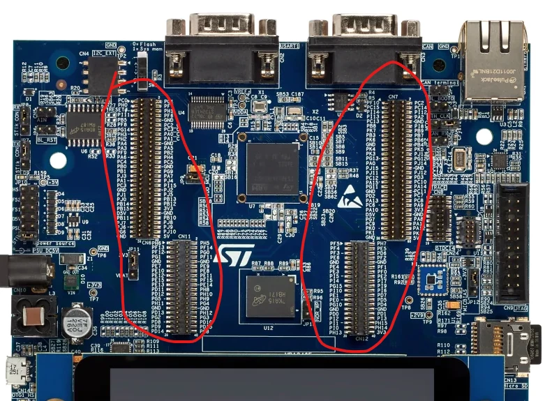

Are daughter boards for Eval boards available?
I'm looking for prototyping daughterboards for the STM32H757I-Eval boards. Is that something that is readily available or are we on our own for building those?
If I need to build my own boards, what is the best connectors for those male pins located on the board? They seem like a tight pitch and isn't something I'm familiar with.0693W00000Y7Xc8QAF.png

Hello @Richard Lowe​
I advise you this guide that will help you to create a daughterboard for the STM32H757I-Eval boards:
  • UM2198 Evaluation boards with STM32H743XI and STM32H753XI MCUs, is your reference on this topic.
Imen
