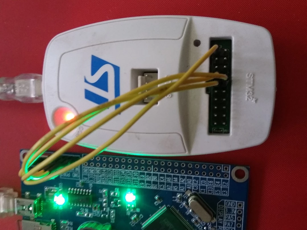

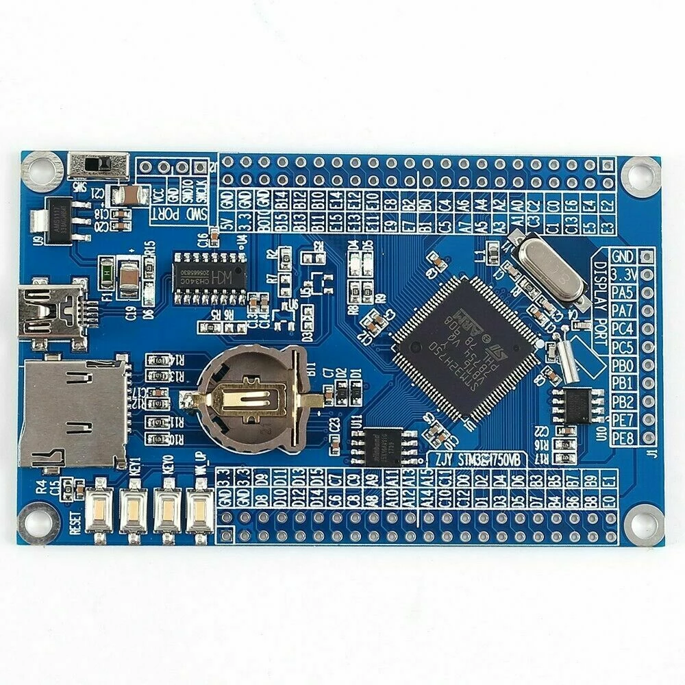

Anyone has a schema of this STM32H750 board?
E-bay sellers don't have any docum, even Chinese.
It contains some I2C eeprom and SPI flash - but to which SPI and I2C they are connected?
Also, I've tried to wire up a white ST-LINKv2 dongle to the SWD debuger contacts, but no success. According to this.
No software can see the target.
The board is alive. It has some test firmware from the factory that blinks LEDs and emulates a USB COM port to host. (but the port does not output anything and does not react to input at 9600 or 115200).

Have you wired the reset and SWO to the debugger tool?
Still cannot get it working...
-- pa
Tesla DeLorean
Guru
November 24, 2019
Just wired VCC, GND, SWDIO, SWCLK
(1) Top Left VCC
(8) Right 4th Down GND
(7) Left 4th Down SWDIO
(9) Left 5th Down SWCLK

Great, thank you

VDDA/VREF+ isn't bypassed with any capacitors! They are not even able of copying reference design.
Buttons also could be debounced...
I"ve pulled the buttons up and down, as Clive advised, They work good enough for me. Will post the Cube file later, for those who cubes))
