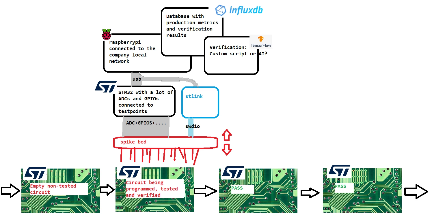

I am planning to automate the Circuit Verification for inhouse designed&assembled electronics, this is my rudimentary idea:
(For me ,the blurry concepts because lack of experience are the Tensorflow and database parts)
Does anyone have experience/ideas that want to share with me?

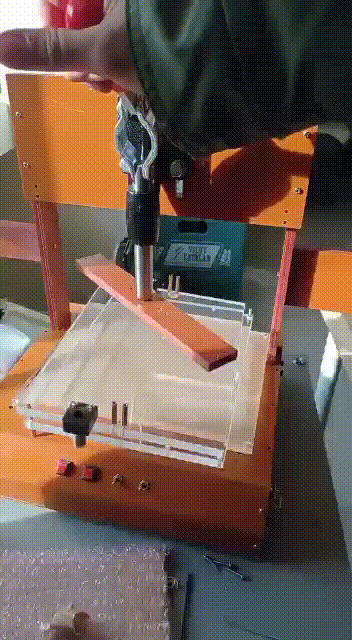

I found some people doing similar stuff:
https://mobile.twitter.com/arturo182/status/1465714409557221377
