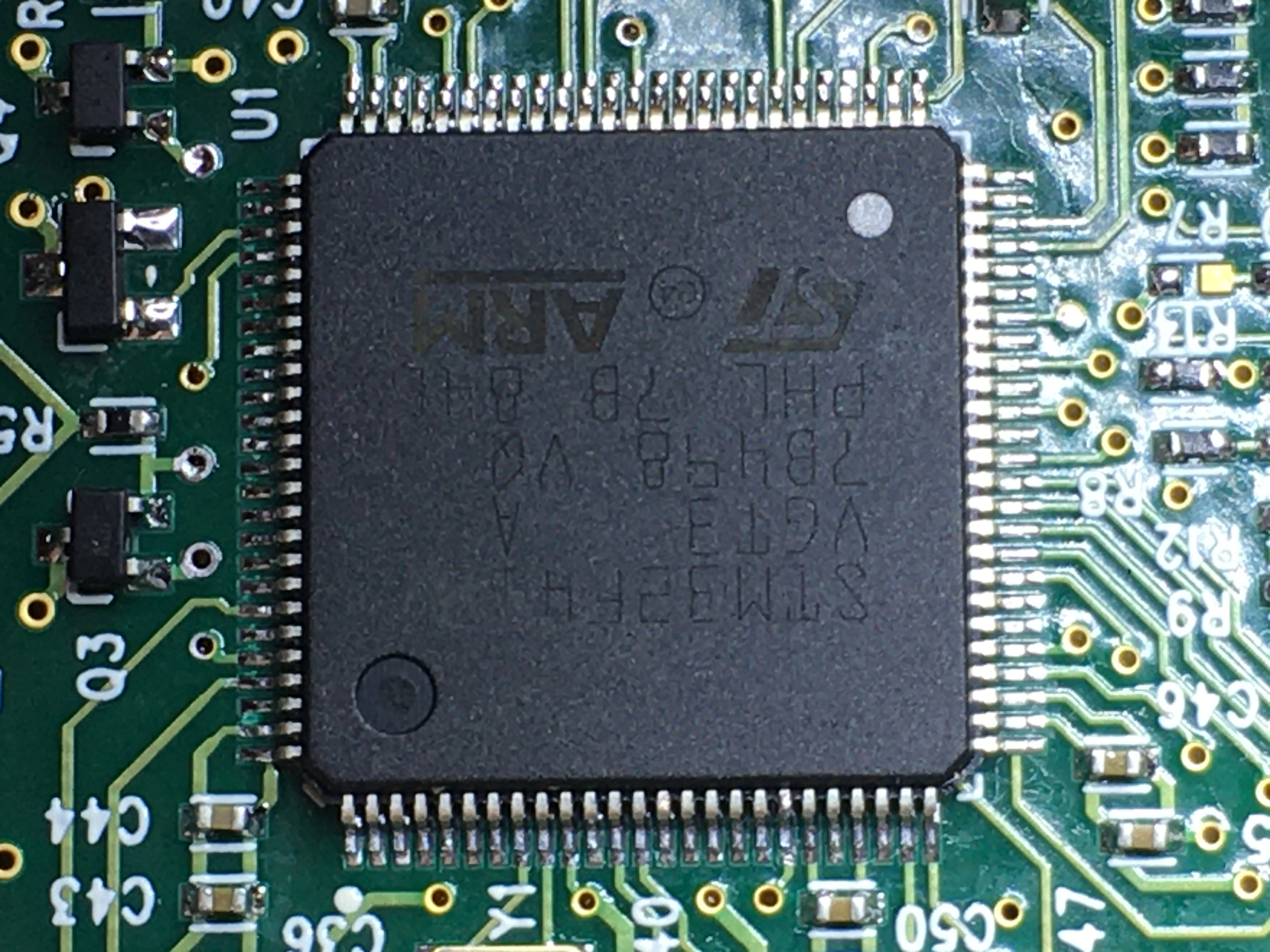

I have just wasted three solid days of very intense bench work trying to understand why my STLINK programmer will not communicate with my newly-created 32F419 target board. As a result I am now an unintended expert on SWD programming.
The reason my target board won't work is that the 32F413 is installed 180 degrees from the correct placement. I assumed that the dot inside the dimple is the pin #1 identification mark.
Wrong. Pin #1 is identified by the dot without an underlying dimple.
STMicro needs to correct the Pin #1 marking ambiguity in the mechanical drawing in the datasheet for the LQFP100 package.

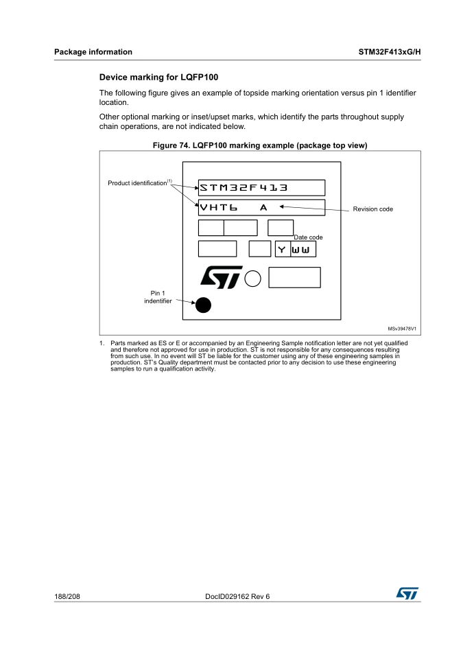

This is ejector mark (ejector is a moving pin which ejects the part from the mold into which the plastic was injected), and it can be confused for the pin1 marker.
Placement, size, appearance, number, etc. of these marks is dependent on the particular site where the given part was packaged, ST uses several such sites so that may change.

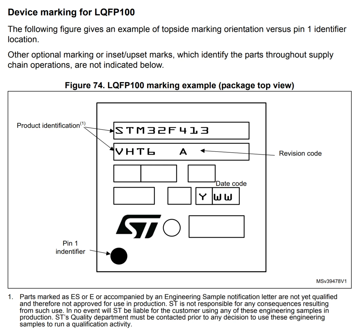

The placement of pin 1 relative to other markings is indicated in the datasheet:

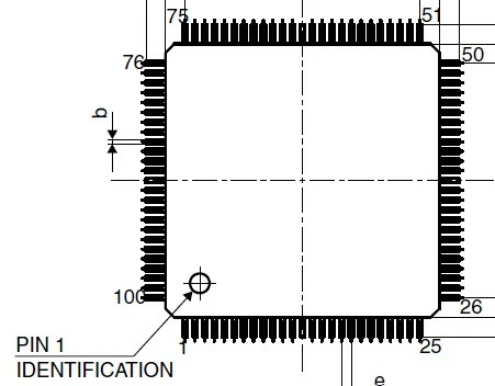

0693W00000Dq8AeQAJ.jpgThanks, guys. I was looking at the mechanical data on the prior datasheet page.

This has been a long standing cause of issues, without doubt.
One problem is that there are multiple sites and equipment involved in the encapsulation and laser marking of devices. Third-party in some cases.
One of the additional tells is the orientation of the part markings, part should be readable (English, Western sense) and pin#1 toward lower left corner.

August 23, 2021
The marking in relation to the text is shown in the datasheet.
