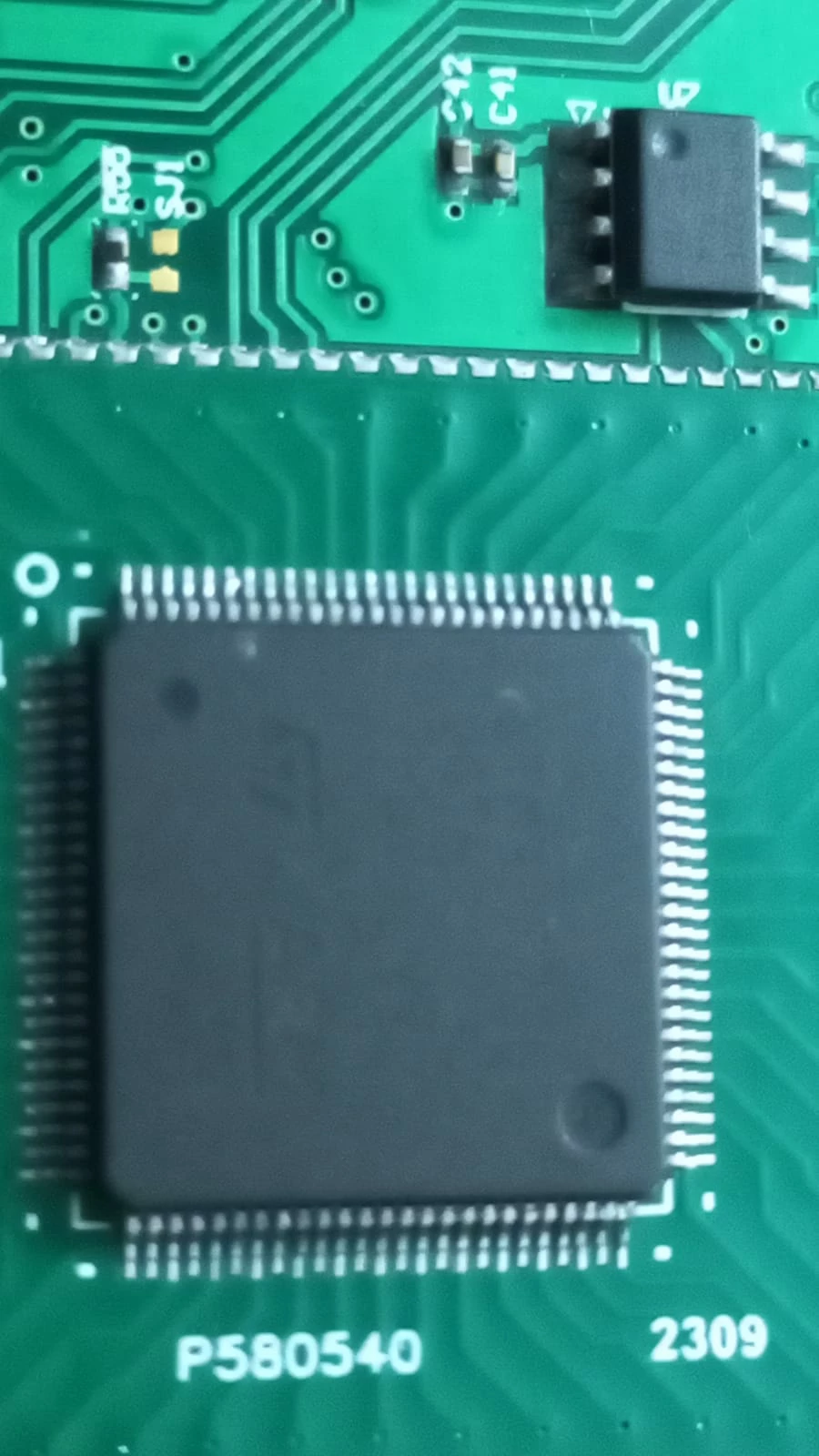

I have a STM32F756VGT6.
Please see picture attached.
There are two dots and the datasheet sheds no light on which could be pin-1
Could someone please clarify this silly question.
Regards
Best answer by waclawek.jan
ST marks the STM32 so that when the text is readable, pin 1 mark is at the left bottom corner.
