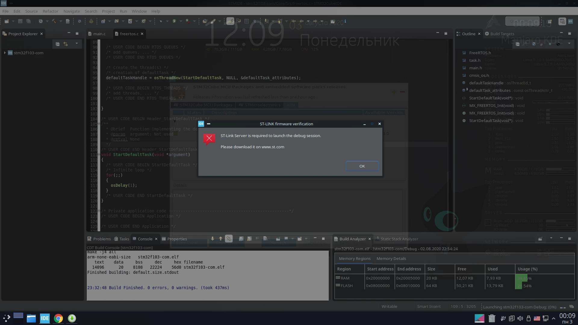

After updating CubeIDE to version 1.4.0 (Linux), the debugger does not work.
  • August 2, 2020
  • 29 replies
  • 12139 views
0693W000003BtojQAC.pngAfter updating CubeIDE to version 1.4.0 (Linux), the debugger does not work.
A window appears
 "ST-LINK firmware verification"
in which there is a message - "STLink server is required to launch the debug session".
How to fix it?

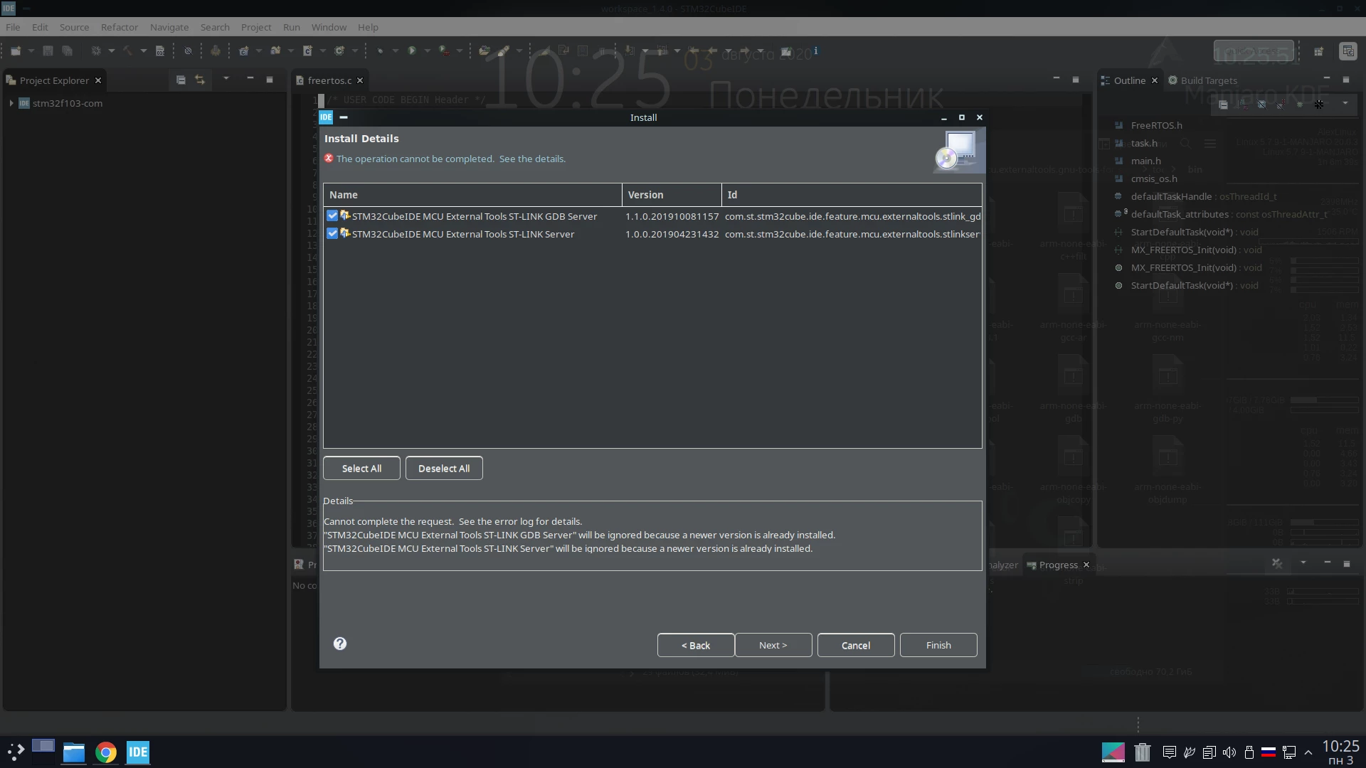

I tried to download STLINK Server from the HELP menu -> Install new software.
Here is the result.
As far as I understand, these elements are present. And the file you specified in the specified path is also there.
I don’t understand what’s the matter ... everything worked before. Ide reinstalled, the result is the same. It works on Windows.
Maybe the paths are not spelled out somewhere?

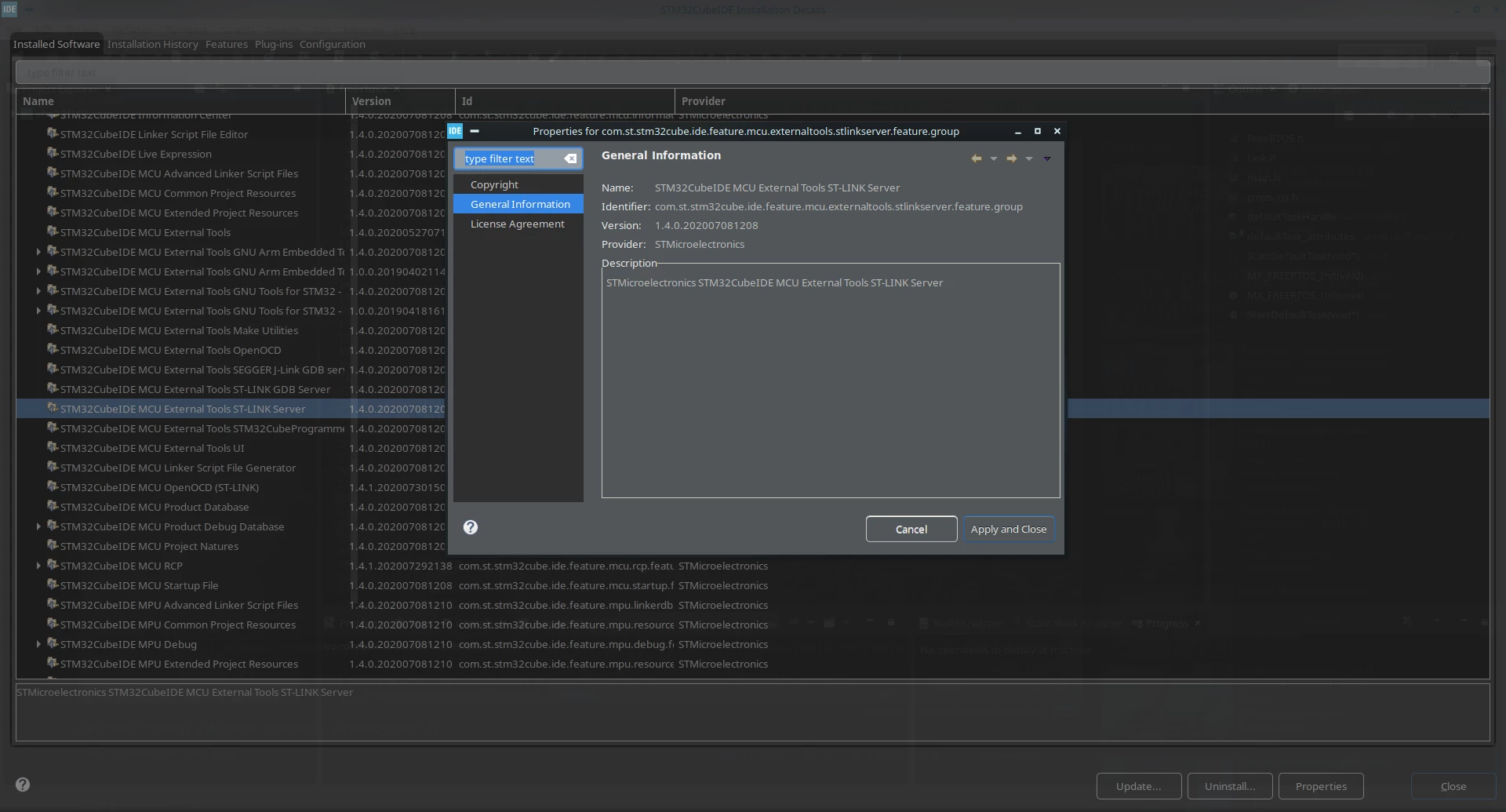

AKova.2
AKova.2Author
August 3, 2020
The list of installed packages contains STLINK Server.0693W000003BuxDQAS.png
KnarfB
August 3, 2020
> Here is the result.
Yes those are outdated versions from last year. The error message is correct.
There should be no need to install STLINK Server separately.
I would try re-installing STM32CubeIDE from scratch.
