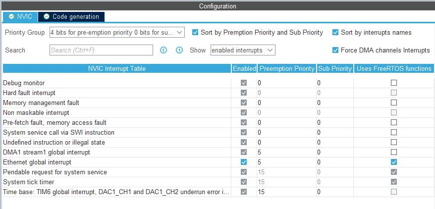

This is NVIC Table of my current imlpementation.

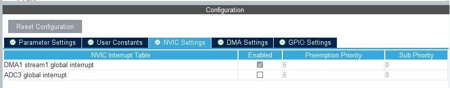

 Following is ADC NVIC Part

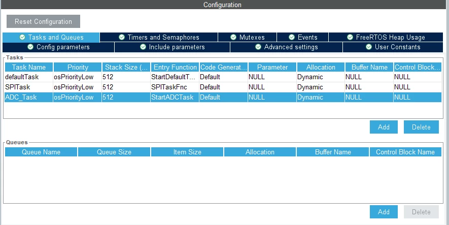

 These are the task configuration of my implementation.

> Currently, I'm encountering an issue where the SPI runs smoothly without DMA enabled. However, as soon as I enable ADC with DMA, the system halts.
Sounds like your ADC-based DMA interrupts are happening too often. How often are they occurring? Perhaps slow down the sample rate and/or use a larger buffer size.

@TDK Thank you for your response. I've increased the buffer size to 10 and extended the sampling time from 2.5 cycles to 12.5 cycles. My ADC clock is running at 48MHz, and I'm using a prescaler of 1. However, even after increasing the buffer size, only 4 out of 10 indexes are consistently being filled, while the other indexes are being ignored most of the time.
Additionally, when a TCP client connects to the board, the DMA transfer halts, although upon checking the ADC data register (DR), it continues to provide values continuously.
March 19, 2024
Slow them down even more. By a factor of 100.

I have increase sampling time from 12.5 to 245 ticks but still the updating response of buffer is very slow while Data register is still updating at normal speed.
This only happens when I connect the client to my TCP server (STM32).
