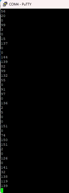

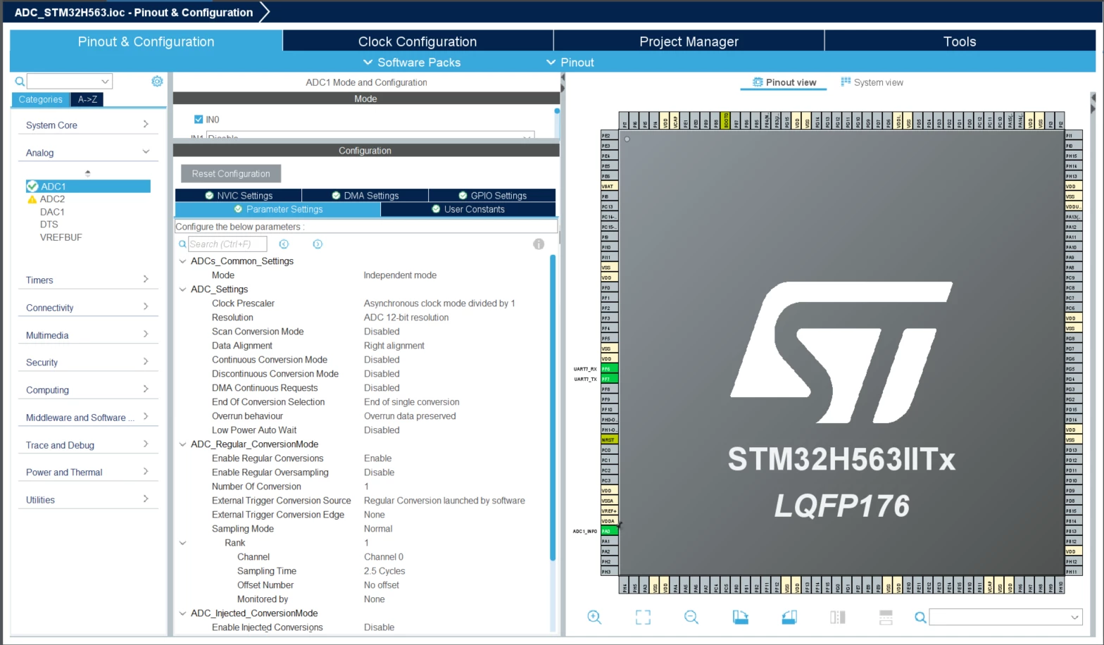

I'm using STM32H563ZIT6 (Nucleo Board) and configured a single ADC input pin PA0, with a frequency of 32MHz and the following configuration as in image. However, when the ADC pin is connected to ground, the ADC value oscillates between 0 and 152 ADC counts. Please help me to solve this issue.
4 replies

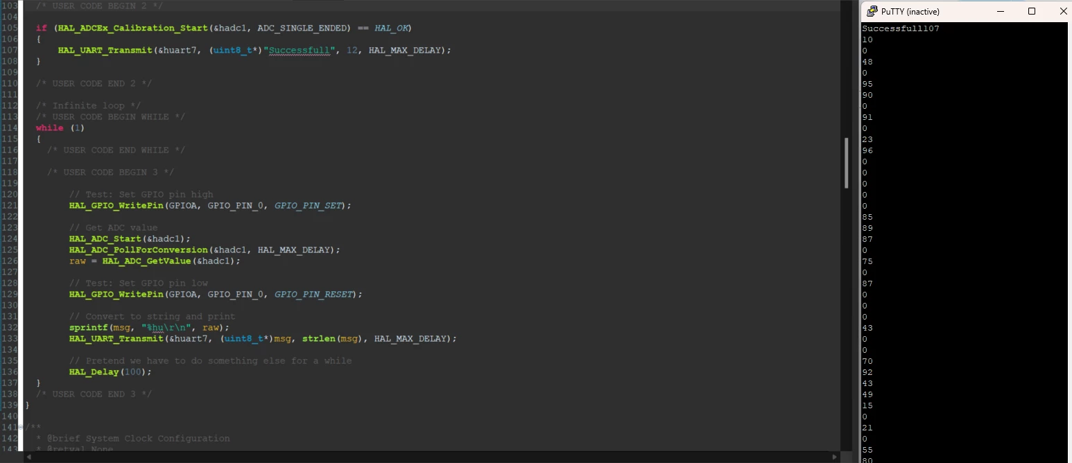

March 9, 2024
Thanks for the reply,  I have calibrated the ADC as you mentioned and the results are better but still I'm getting the ADC value up to  96.
if (HAL_ADCEx_Calibration_Start(&hadc1, ADC_SINGLE_ENDED) == HAL_OK)
HAL_UART_Transmit(&huart7, (uint8_t*)"Successfull", 12, HAL_MAX_DELAY);
I'm working in a project where I need to configure 14 ADC pins, so I have actually configured 14 ADC pins using DMA, but in 11 ADC pins I'm facing the same issue (Getting oscillating ADC value up to 200 ADC counts). So I have created a new project and configured only a single ADC pin (without DMA) and posted earlier.
As for the remaining 3 ADC pins,
1. In two ADC pins (PC4 & PC5) - The voltage of sensor output pin is reduced when connected to the ADC pin of the STM32H563 controller.
2. In last ADC pin (PA2) - The voltage of sensor output pin is Increased when connected to the ADC pin of the STM32H563 controller.
But when i give 3.3v to the ADC pins, i got 4095 (12 bit max value) from all 14 ADC pins.

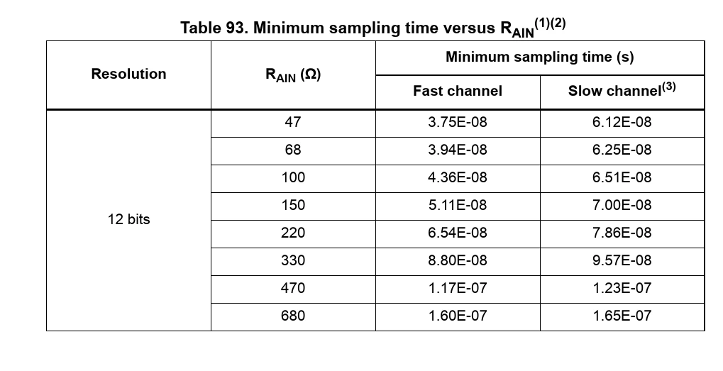

AScha.3
March 9, 2024
Ok, so next "problem" : you set very short sampling time, this works only on low impedance input.
-> read in ds...
and set longer sampling time or (if slow signal or DC ) a big cer.cap (100nF or so) on short connection adc-input to gnd.
If still "Getting oscillating ADC value" look with a scope on adc-input pin - maybe adc is right. :)
